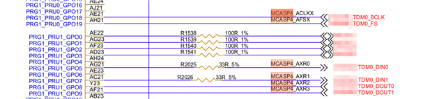

Now I use following design:
I now mcasp4 have 4 serializers:
PIN_PRG1_PRU0_GPO18 as MCASP4_ACLKX
PIN_PRG1_PRU0_GPO19 as MCASP4_AFSX
PIN_PRG1_PRU1_GPO5 as MCASP4_AXR0 (this is output)
PIN_PRG1_PRU1_GPO7 as MCASP4_AXR1 (this is output)
PIN_PRG1_PRU1_GPO8 as MCASP4_AXR2 (this is input)
PIN_PRG1_PRU1_GPO9 as MCASP4_AXR3 (this is input)

Q1:
If I refer to createStreams() in pdk_jacinto_09_02_00_30/packages/ti/drv/mcasp/example/src/audioSample_io.c, do I only need to create TX and RX once?
Q2:
I use all the serializers of the mcasp4 mentioned above to transmit and receive TDM16 data, so how do I configure the distribution of the transmitted or received TDM16 data?
For example:
slot0 slot1 .....solt15 During the receiving process, which slots are in serializer 3 and which slots are in serializer 4?
I can't find the above information in TRM, could you please point it out to me?
