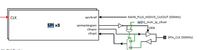

We have new project needs two SPI interfaces, we choose MCSPI0 channel0  and MCSPI5 channel2, MCSPI0 channel 0 is working fine, no issue, but MCSPI5 channel2, we see signal output on SPI5_CS2 and SPI5_MOSI, but no signal on SPI5_CLK, we used pins Y27(SPI5_CS2, configure mode 8), T27(SPI5_CLK, configure mode 8), R27(SPI_MOSI, configure mode 8), AD27(SPI_MISO, configure mode 11). I verified these pins hardware connection by setting these pins as GPIO output and toggling them),
refer image: probe 1: T27(SPI5_CLK),probe 2: AD27(SPI5_MISO),probe 3: Y27(SPI5_CS2),probe 4: R27(SPI5_MOSI)

    If you pin mux it to GPIO it the PIN might work for GPIO but this doesn't confirm you configured GPIO Expander correctly for SPI5. For SPI5_CLK you need to do Mux Selection. Can you share us how you have configured GPIO exapander using I2C?
    MCSPI driver used 8.5.0.11 because 9.2.0.30 MCSPI driver does not work for us.
    SPI CLK has nothing to do with driver . SPI CLK is a direct connection in soc
    If you do proper PIN Mux and GPIO Expander selection it is a direct hardware connection
    Tarun Mukesh

    You are mentioning it as custom board , so can you share the schematics of SPI5_CLK from soc where it is being driven to ?
    By the way, we are using SPI5 as master, we see data on MOSI pin even no SPI5 clk, I do not see doc for I2C configure expender forSPI5 clk.
    If spi_clk is not there then there is no such chance of data transfer on SPI. MOSI data  present implies SPI_CLK is available , the issue can be with probing out signal.
