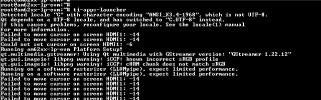

We are using the TI processor SDK ti-processor-sdk-linux-am62xx-evm-11.00.09.04. I am building the Linux kernel and copying Kernel images, dtbs and modules into the RootFS.
I didn't do any modifications in the Filesystem. The launcher TI apps is not showing in the HDMI.
Please let me know your inputs on the same

  • Hi Johnson John,
    I am getting below error in my HDMI display after the boot:
    Still, I can able to re-launch the apps like below:
    But I couldn't navigate the mouse inside the apps, it keeps on printing the error:
    Failed to move cursor on screen HDMI1: -14
    Please let me know the solution of this same.
    I have attached the complete logs also here

    root@am62xx-lp-evm:~# ti-apps-launcher
    Detected locale "C" with character encoding "ANSI_X3.4-1968", which is not UTF-8.
    Qt depends on a UTF-8 locale, and has switched to "C.UTF-8" instead.
    If this causes problems, reconfigure your locale. See the locale(1) manual
    for more information.
    Could not set cursor on screen HDMI1: -6
    Running am62xx-lp-evm Platform Setup!
    qt.multimedia.gstreamer: Using Qt multimedia with GStreamer version: "GStreamer 1.22.12"
    qt.gui.imageio: libpng warning: iCCP: known incorrect sRGB profile
    qt.gui.imageio: libpng warning: iCCP: cHRM chunk does not match sRGB
    Running on a software rasterizer (LLVMpipe), expect limited performance.
    ^Croot@am62xx-lp-evm:~#
    Thanks in advance
    Salih

  • Hi Salih,
    A few questions for you:
    1. Since you are using TI EVM are you using default SD card image, are you modifying something in kernel and then rebuilding and using this.
    2. I am assuming you tried with the default SDK image and that worked? If so what changes have done in kernel that led to this?
    While using the pre-built binaries, there is no such issues observed. But while buidling the Linux and the modules, then I have copied those Image and DTB files into the SD card. Also I have copied the modules under /lib/modules. At this instant, I'm facing this issue. I didn't modify any code changes inside the Linux Kernel.
    Thanks in advance.
    Salih
    This observation is not expected to happen.
    There must have been some change. Help me out with the following:
    1. Share your build steps exactly, including the commands you used to build and copy.
    Did you use make linux and then make linux_install?
    2. In the non-working case, share the output of following:
    lsmod
    systemctl stop emptty
    kmsprint
    modetest -M tidss
    modetest
    ls -l /dev/dri/*
  • You may also need something like this when you trying to manually run the demo:
    WAYLAND_DISPLAY=wayland-1 QT_QPA_PLATFORM=wayland XDG_RUNTIME_DIR=/run/user/1000 ti-apps-launcher
