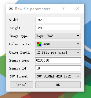

My pictures of objects under the sun are overexposed and have serious color cast,
but the objects under the lights are not overexposed and the colors are normal.
I tried to get a frame to analyze the histogram,
but the raw file captured by DCC tools cannot be opened in photoshop.
Meng
here is my raw properties
  • Hello Mr. Meng,
    When the sensor's raw output has 12 bits per pixel, the raw files captured by the DCC tool or by other tools like yavta or v4l2-ctl contain pixel data in 16-bit entities. This format may not be recognizable by Photoshop.
