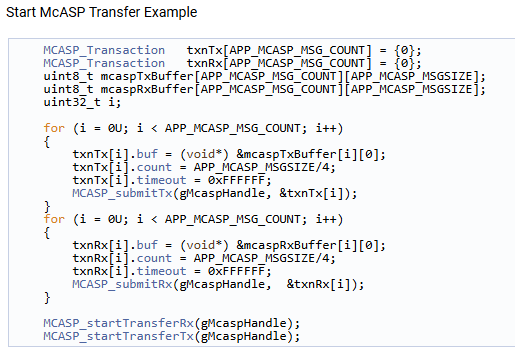

    3. Why is the count passed in the MCASP Transfer example divided by 4?
    If you check the sysConfig->Mcasp->transmit configurations, you can see that the slot size is set to 32.
    In the mcasp_playback.c file, you can see the definition of the transmit and receive buffers ->
    uint8_t gMcaspAudioBufferTx[APP_MCASP_AUDIO_BUFF_COUNT][APP_MCASP_AUDIO_BUFF_SIZE] ,
    The buffers are declared uint8_t. So 4 elements in the buffer actually make up one slot. To get the number of slots, we divide the APP_MCASP_MSGSIZE by 4.
