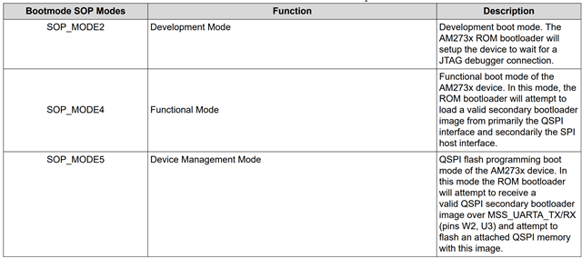

  • Ito,
    Ok, I think there are a couple things that we need to start with here.
    First, in the ccxml file, you should leave the Board or Devices as evmAM273x.  Using the board file will include a lot of the device initialization gel files that is not included in the device only selection.  If you want to use the AM273x device selection here, you need to include all the device initialization in your boot loader.
    Also, I think you have the wrong SOP line selection.  Per the AM273 datasheet:
    If you are trying to connect to the AM273 device via the XDS200, you need the device to be in SOP_MODE2 - Development Mode.  This means you need SOP2 = 0, SOP1 = 1, and SOP0 = 1.
    There may be some issues with changing the QSPI device, but lets get the XDS200 fully functional with the AM273 first, then determine what problems exist with the QSPI device.

  • Hi All,
    The solution was to change the EVM board file and change the SOP.
    Ito
