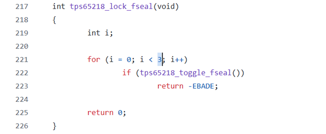

Using SDK9 with AM3351 and TPS65218D0PHP, how do I set the PMIC FSEAL bit using the TI-written driver?
*** 7/25/25: I'm updating this post to include my colleague's description from below.  Since we've not seen a response from TI yet, I'm adding this to the original post to be sure the problem statement is clear:
Specifically, we're using the TPS65218 driver.  We found the function "tps65218_lock_fseal()" in pmic_tps65218.c, but it's not clear to us how we're intended to invoke it; it doesn't appear to be called from elsewhere in the driver, and it doesn't seem to be exposed to an ioctl or similar.  Is there any guidance as to how this is supposed to be used?  In case it's relevant, our product mainly runs as a user-space application under Linux, but we're comfortable with rebuilding the kernel if necessary.
Summary: Is there any knowledge of the function "tps65218_lock_fseal()" in pmic_tps65218.c??  Does it work?  How is it invoked?

  • Hi Owen,
    Since this function is part of the U-Boot driver, I've found an example of where it's used. Hope this is applicable to what you were looking for.
    https://concept.u-boot.org/u-boot/u-boot/-/blob/acce3463797def22b71e3c6d8ff9a4844941cdf7/board/compulab/cm_t43/cm_t43.c
  • Thanks! I'd missed that the function was actually in U-boot rather than the kernel, but porting it to the kernel driver was straightforward (I put it in the tps65218.c file, at the end of the probe function).
    However, while it runs, it doesn't seem to actually set the FSEAL bit.  In the driver I put a readback of the status register after attempting to set FSEAL, and it's still reported as 0x08.  I added some code to monitor the register writes to the PMIC, and it's reporting what I'm pretty sure is the correct sequence (register 0x10, with the values 0xb1, 0xfe, 0xa3, 0xb1, 0xfe, 0xa3, 0xb1, 0xfe, 0xa3).  Are there any suggestions as to what might be going wrong there?

  • Hi Owen,
    Could you clarify, that there aren't any readbacks performed between the writes, and the readback is performed strictly after the writing sequence is done?
    Any interruption to the consecutive writes could disturb the sequence.
    If this isn't the issue, then could I suggest setting this integer to 1 or 2 to see if this changes the FSEAL bit?
    The three writes should be locking the bit as '1', but I would want to test if the bit is being successfully toggled at all in the first two writes.

  • Hi Sarah,
    That's correct on the readbacks: we issue the writes consecutively, with no intervening reads, and we read the status right afterwards.
    Changing the loop counter to 1 or 2 made no difference; we get a status of 0x08 for 1, 2, and 3 loop iterations.

  • Hi Owen, Tom,
    Thanks for the insight.
    Could you clarify what you mean by "IN_BIAS is unused, pulled high" ?
    IN_BIAS should just be the supply voltage to the PMIC, 2.7 V - 5.5 V.
    Please ensure that the proper input voltage is being supplied.
    Please keep the coin cell inserted when setting the FSEAL bit.
    We have noticed that the CC pin needs to have a valid voltage of 2.2 V - 3.3 V in order for this bit to be set properly.
    Could you also try hooking up some sort of I2C sniffer to the bus to ensure that these write commands are being received on the hardware side?

  • Hi Sarah,
    We found a problem in the test hardware.  This issue is resolved, thank you.
    We've moved "tps65218_lock_fseal()" into the kernel and it is performing as expected now.
