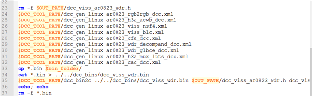

I want to adjust the CAC module.
I calibrated the CAC block using the MATLAB script and DCC tool as follows:
[FAQ] TDA4VH/AM62A: How to create the CAC mesh LUT for DCC tuning tool input? - Processors forum - Processors - TI E2E support forums
cac_shift_1 = [0, 0; 400, -2; 800, -4; 1600, -8; 2400, -15; 3300, -20; 4000, -30];
cac_shift_2 = [0, 0; 400, +2; 800, +4; 1600, +8; 2400, +15; 3300, +20; 4000, +30];
im_sz = [2160, 3840];
hc = im_sz(2) / 2;
vc = im_sz(1) / 2;
make_cac_lut('cac_lut_m.txt', im_sz, hc, vc, cac_shift_1, cac_shift_2);

The CAC_XML is generated, and CAC_XML is added in./generate_dcc.sh
ar0823_cac_dcc.xml
 but the image is found to be unchanged after compilation
Is there anthing wrong with my setting
