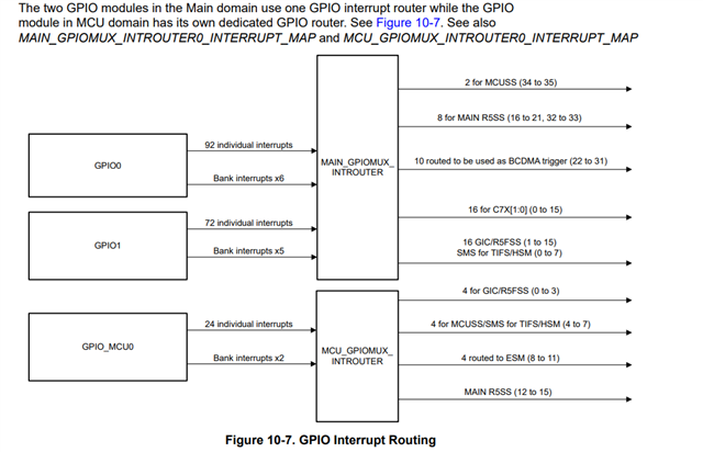

J722SXH01EVM: on j722s evm, gpio test case not passed.
Part Number: J722SXH01EVM
Hi TI expert,
     1. i am using J722s evm  and sdk v11  sdcard, spl boot mode.
     2. test project is :   mcu_plus_sdk_j722s_11_00_00_12/test/drivers/gpio/  running on mcu10.
     3.  by default, it failed on  "GPIO_TRIG_TYPE_BOTH_EDGE" case, since  GPIO_getBankIntrStatus not get correct status, it return 0 as most cast.   but change delay x10 smaller, it will pass.
     4.  in rising trigger case, it's passed by default, but when add more delay, eg. change times 1000  to 3000, it will also failed.
my question is:
    1.  why a long delay  after setting a gpio level will not get the right status, mostly get zero.
     2. a quick read bank status seems not get the real status,  how to solve this?
