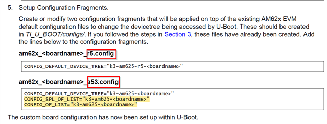

There is minimal dts for custom board bring up, and there is a app notes: https://www.ti.com/lit/an/spradd1a/spradd1a.pdf
But it is dropped in SDK11.x.
In the application notes page 7, is the .config file name wrong? should be _deconfig?
And there is not these two line in _deconfig file: I checked am62x_evm_a53_deconfig file from SDK8.3 to SDK11, none have below two line.
CONFIG_SPL_OF_LIST="k3-am625-<boardname>"
CONFIG_OF_LIST="k3-am625-<boardname>"
    Yes, I confirm the minimal dts has been dropped in SDK11.0 and 11.1. I have filed an internal ticket to request to add it back in SDK11.2.
    _defconfig might be consistent with the existing files, but .config filename is also okay, since you would have to use the full filename when use the defconfig.
    These two lines are not in am62x_evm_a53_deconfig in the SDK. You can skip them if only one board will be supported by the U-Boot. They are mandatory if two or more boards are supported in U-Boot.
