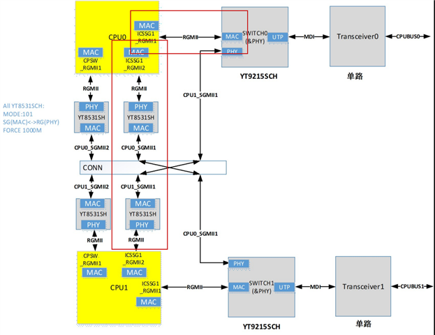

Two modules are communication, for example at both ends of CPUBUS0 A module and B module, they will send and receive data to each other.
During running, after unplugging the A module with am6442 and using Cortex-A53 core, it happened that ICSSG1_RGMII1 and ICSSG1_RGMII2 are unable to receive any data, receiving interrupt is not triggered.

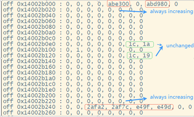

Then PRU_STAT memory data are as follows:
offset=0xF8 0xFC 0x138 0x13C these values are not incremented when send and receive data with module B.
offset=0x10/0x18/0x248/0x24c/0x250/0x254 these values are always incremented send and receive data with module B.
But this time the receive interrupt are not triggered for ICSSG1_RGMII1 and ICSSG1_RGMII2 ports and send interrupt is triggered OK.
