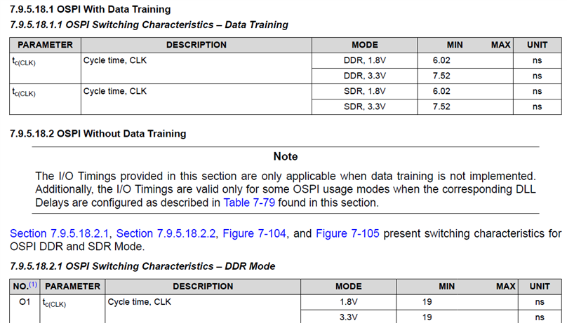

  • Tanmay,
    Please do confirm this with validation team.
    I checked into DRA821 Data Manual, for OSPI without Data Training in DDR mode, the min clock cycle is 19ns which is close to 50Mhz. For SDR mode, the min clock cycle is 7ns and 7.52ns which is at least 133Mhz.
    With Data Training, DDR mode 1.8V can achieve 166Mhz and 3.3V can achieve 133Mhz.
    I would like to confirm whether Data Training is equal to PHY mode you mentioned in this post?
    There is no such limitation on AM62x and AM64x and I wonder if this is a hardware limitation or software configuration limitation probably from PLL clock.
    May you contact our OSPI flash driver developer to double confirm this?
    BR, Rich
  • Hi Rich,
    Yes. Data training is the phy mode I mentioned before.
    Tanmay
  • Tanmay,
    In this case, the OSPI/QSPI could achieve ~50Mhz even without PHY mode (No Data trained).
    This should not be a limitation to OSPI/QSPI flash. (In fact, we don't have this limitation on our other platforms including TDA4.)
    Please help to make 40Mhz clock work on EVM QSPI flash and provide a patch on how to enable the support. (no matter PHY mode or non PHY mode)
    BR, Rich

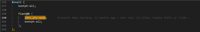

  • Hi experts,
    Sorry to hi-jack the thread but I am also very interested in getting the speed up on QSPI (on ospi1).
    Using spi-tx-bus-width = <4> in U-Boot, I have never gotten any stability. I can write to the nor flash but the following reads shows garbled bytes.
    Can you confirm that using quad lines on both tx and rx works in both U-Boot and Kernel? If yes, what are the dts-settings and what is the highest speed we can achieve?
    Also, regarding phy-mode, there is a commit, 11 months old:
    Where cdns,phy-mode is added to ospi1, which is used for qspi-nor. Is this an error?
    /Bo

  • My patch
    diff --git a/arch/arm/dts/k3-j7200-common-proc-board-u-boot.dtsi b/arch/arm/dts/k3-j7200-common-proc-board-u-boot.dtsi
    index dd17d04c..54167b7f 100644
    --- a/arch/arm/dts/k3-j7200-common-proc-board-u-boot.dtsi
    +++ b/arch/arm/dts/k3-j7200-common-proc-board-u-boot.dtsi
    @@ -195,7 +195,6 @@
    bootph-all;
    flash@0 {
    - cdns,phy-mode;
    bootph-all;
    diff --git a/arch/arm/dts/k3-j7200-mcu-wakeup.dtsi b/arch/arm/dts/k3-j7200-mcu-wakeup.dtsi
    index 07f44a59..37ac2c23 100644
    --- a/arch/arm/dts/k3-j7200-mcu-wakeup.dtsi
    +++ b/arch/arm/dts/k3-j7200-mcu-wakeup.dtsi
    @@ -548,16 +548,14 @@
    ospi0: spi@47040000 {
    compatible = "ti,am654-ospi", "cdns,qspi-nor";
    reg = <0x0 0x47040000 0x0 0x100>,
    - <0x5 0x00000000 0x1 0x0000000>;
    + <0x5 0x00000000 0x1 0x0000000>;
    interrupts = <GIC_SPI 840 IRQ_TYPE_LEVEL_HIGH>;
    cdns,fifo-depth = <256>;
    cdns,fifo-width = <4>;
    cdns,trigger-address = <0x0>;
    - clocks = <&k3_clks 103 0>;
    - assigned-clocks = <&k3_clks 103 0>;
    - assigned-clock-parents = <&k3_clks 103 2>;
    - assigned-clock-rates = <166666666>;
    - power-domains = <&k3_pds 103 TI_SCI_PD_EXCLUSIVE>;
    + cdns,phase-detect-selector = <2>;
    + clocks = <&k3_clks 104 0>;
    + power-domains = <&k3_pds 104 TI_SCI_PD_EXCLUSIVE>;
    #address-cells = <1>;
    #size-cells = <0>;
    status = "disabled";
    diff --git a/arch/arm/dts/k3-j7200-som-p0.dtsi b/arch/arm/dts/k3-j7200-som-p0.dtsi
    index 910a4b5c..b5a7fb64 100644
    --- a/arch/arm/dts/k3-j7200-som-p0.dtsi
    +++ b/arch/arm/dts/k3-j7200-som-p0.dtsi
    @@ -427,14 +427,14 @@
    flash@0 {
    compatible = "jedec,spi-nor";
    reg = <0x0>;
    - spi-tx-bus-width = <8>;
    - spi-rx-bus-width = <8>;
    - spi-max-frequency = <25000000>;
