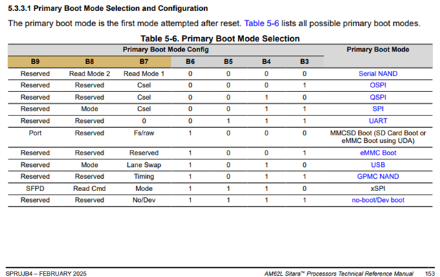

AM62L: Does AM62L support SPI NOR flash boot?
Part Number: AM62L
Champ,
Customer would like to confirm whether SPI NOR flash boot is actually supported in AM62L.

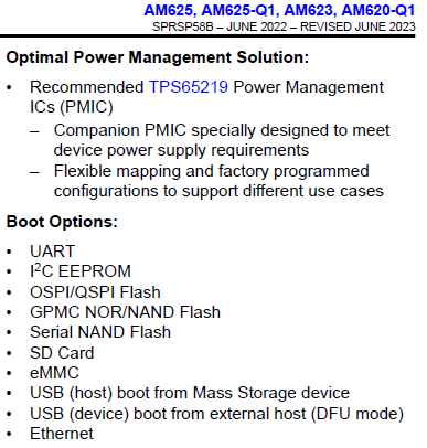

We know it is supported in AM62x but need to confirm the availability in AM62L since the ROM code has been changed.

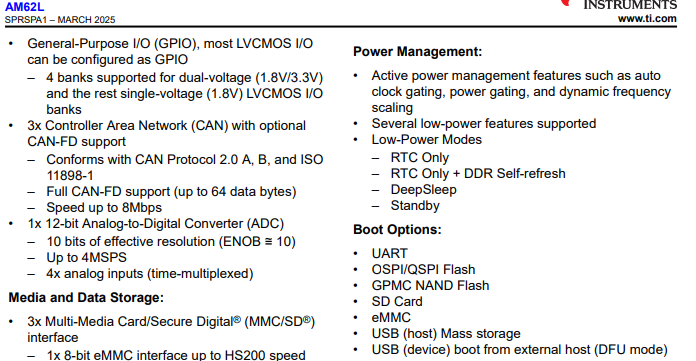

I am posting this to confirm whether SPI boot is supported or not in AM62L.
Even In AM62x Data Manual, SPI boot is not listed. Nor in AM62L.
In AM62L TRM chapter 5, SPI boot is listed.
