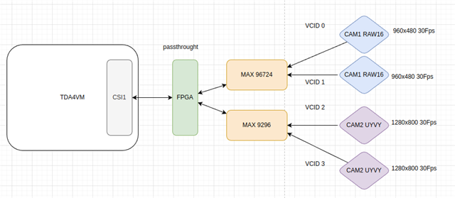

Our project design is as follows, SDK RTOS 0806.
1. Is this solution ok?
2. How to configure the buff array?
thanks

Hi Dongzhang,
As long as your fpga is giving output in MIPI CSI format it should be fine.
Can you give more info on this, are you asking about openvx buffers ?
Gokul
hi,
[FAQ] TDA4VM: Stream camera of 2 datatypes using 2 Capture nodes and 2 Graphs on the same csi-rx instance
I got the FAQ like the problem.
