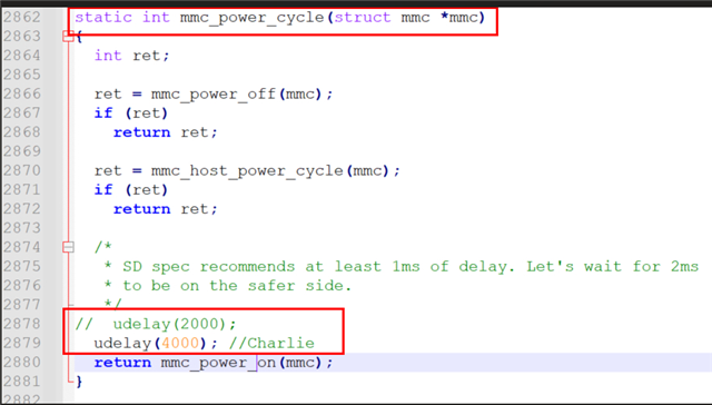

  • The SD Card should have the ability to change voltages from 3.3V to 1.8V to achieve higher frequencies.  The boot log indicates that you have a problem with your board when performing this voltage switch.
    Can you try using sdhci_caps_mask as described here: https://software-dl.ti.com/processor-sdk-linux/esd/AM62X/latest/exports/docs/linux/Foundational_Components/U-Boot/UG-Memory-K3.html#steps-for-working-around-sd-card-issues-in-u-boot
    to limit the speed to SD legacy mode.  This will help to see if the voltage switch is the issue.
    The SDK also uses a IO expander (pca953x), which is on the EVM.  If you do not have that implemented on your board, you will have to change the device tree accommodate this.
    James

    The current status after modification is as follows:
    U-Boot SPL 2025.01-gcd91d7360181-dirty (Jul 29 2025 - 10:42:04 +0800)
    SYSFW ABI: 4.0 (firmware rev 0x000b '11.0.7--v11.00.07 (Fancy Rat)')
    Changed A53 CPU frequency to 1250000000Hz (T grade) in DT
    SPL initial stack usage: 13424 bytes
    Trying to boot from MMC2
    Authentication passed
    Starting ATF on ARM64 core...
    NOTICE: BL31: v2.12.0(release):11.00.08-1-gb11beb2b6-dirty
    NOTICE: BL31: Built : 12:35:58, Mar 24 2025
    U-Boot SPL 2025.01-gcd91d7360181-dirty (Jul 29 2025 - 10:53:34 +0800)
    SPL initial stack usage: 1952 bytes
    Card did not respond to voltage select! : -110
    ** Bad device specification mmc 1 **
    Couldn't find partition mmc 1:1
    Error: could not access storage.
    spl: mmc init failed with error: -95
    SPL: failed to boot from all boot devices
    ### ERROR ### Please RESET the board ###
    The situation is still the same, "Card did not respond to voltage select! : -110". Is there any other direction?
    Thanks.

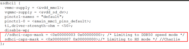

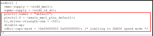

    Please share here only the changes you have done for limiting the SD card speed.
  • If your custom board doesn't support voltage switching, please refer to the following thread also:
    e2e.ti.com/.../sk-am62p-lp-how-to-set-sd-card-to-3-3v-only-low-speed
  • Hi Prashant
    Show as below:
    Thanks.
  • Hi Prashant
    We have tried it, the voltage is not cut to 1.8V, but the console stops at the same part
    Thanks.
  • I see you have limited the speed to DDR50. Please limit it to HS mode only with "sdhci-caps-mask = <0x00000007 0x00000000>".
    If this also doesn't work, please share your changes in git diff format for me to better understand your changes.

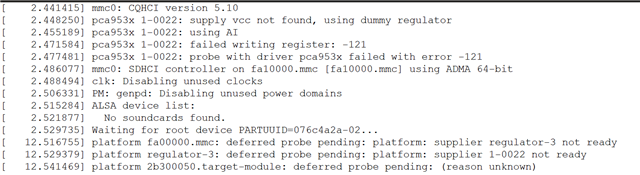

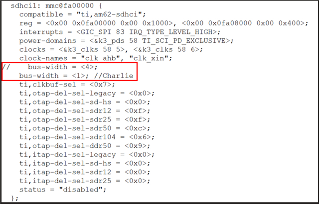

  • HI Prashant
    Thank you for your help, our board can now enter uboot.
    Now we encounter another situation as follows:
    It seems to stop at the point where it enters the kernel.
    We modified the following according to your suggestion:
    The complete boot log is as follows:

    [    2.441415] mmc0: CQHCI version 5.10
    [    2.448250] pca953x 1-0022: supply vcc not found, using dummy regulator
    [    2.455189] pca953x 1-0022: using AI
    [    2.471584] pca953x 1-0022: failed writing register: -121
    [    2.477481] pca953x 1-0022: probe with driver pca953x failed with error -121
    [    2.486077] mmc0: SDHCI controller on fa10000.mmc [fa10000.mmc] using ADMA 64-bit
    [    2.488494] clk: Disabling unused clocks
    [    2.506331] PM: genpd: Disabling unused power domains
    [    2.515284] ALSA device list:
    [    2.521877]   No soundcards found.
    [    2.529735] Waiting for root device PARTUUID=076c4a2a-02...
    [   12.516755] platform fa00000.mmc: deferred probe pending: platform: supplier regulator-3 not ready
    [   12.529379] platform regulator-3: deferred probe pending: platform: supplier 1-0022 not ready
    [   12.541469] platform 2b300050.target-module: deferred probe pending: (reason unknown)

    diff --git a/drivers/mmc/mmc.c b/drivers/mmc/mmc.c
    index 79958689..f53512da 100644
    --- a/drivers/mmc/mmc.c
    +++ b/drivers/mmc/mmc.c
    @@ -2875,7 +2875,8 @@ static int mmc_power_cycle(struct mmc *mmc)
     	 * SD spec recommends at least 1ms of delay. Let's wait for 2ms
     	 * to be on the safer side.
    -	udelay(2000);
    +//	udelay(2000);
    +  udelay(4000); //Charlie
     	return mmc_power_on(mmc);
    diff --git a/dts/upstream/src/arm64/ti/k3-am62-main.dtsi b/dts/upstream/src/arm64/ti/k3-am62-main.dtsi
    index c7773e81..708786c6 100644
    --- a/dts/upstream/src/arm64/ti/k3-am62-main.dtsi
    +++ b/dts/upstream/src/arm64/ti/k3-am62-main.dtsi
    @@ -596,7 +596,8 @@
     		power-domains = <&k3_pds 58 TI_SCI_PD_EXCLUSIVE>;
     		clocks = <&k3_clks 58 5>, <&k3_clks 58 6>;
     		clock-names = "clk_ahb", "clk_xin";
    -		bus-width = <4>;
    +//		bus-width = <4>;
    +    bus-width = <1>; //Charlie
     		ti,clkbuf-sel = <0x7>;

    diff --git a/dts/upstream/src/arm64/ti/k3-am625-sk.dts b/dts/upstream/src/arm64/ti/k3-am625-sk.dts
    index b6373c1a..663388c7 100644
    --- a/dts/upstream/src/arm64/ti/k3-am625-sk.dts
    +++ b/dts/upstream/src/arm64/ti/k3-am625-sk.dts
    @@ -183,6 +183,12 @@
     &sdhci1 {
     	vmmc-supply = <&vdd_mmc1>;
     	vqmmc-supply = <&vdd_sd_dv>;
    +  pinctrl-names = "default";
    +  pinctrl-0 = <&main_mmc1_pins_default>;
    +  ti,driver-strength-ohm = <50>;
    +  disable-wp;
    +  //sdhci-caps-mask = <0x00000003 0x00000000>; /* Limiting to DDR50 speed mode */
    +  sdhci-caps-mask = <0x00000007 0x00000000>;/* Limiting to HS mode */ //Charlie

    diff --git a/arch/arm64/boot/dts/ti/k3-am625-sk.dts b/arch/arm64/boot/dts/ti/k3-am625-sk.dts
    index b6373c1a3..ce177abaf 100644
    --- a/arch/arm64/boot/dts/ti/k3-am625-sk.dts
    +++ b/arch/arm64/boot/dts/ti/k3-am625-sk.dts
    @@ -183,6 +183,12 @@ exp1: gpio@22 {
    &sdhci1 {
    + disable-wp;

    [ 1.760416] xhci-hcd xhci-hcd.0.auto: irq 253, io mem 0x31100000
    [ 1.767527] hub 1-0:1.0: USB hub found
    [ 1.771341] hub 1-0:1.0: 1 port detected
    [ 1.779660] mmc0: CQHCI version 5.10
    [ 1.786652] pca953x 1-0022: supply vcc not found, using dummy regulator
    [ 1.793500] pca953x 1-0022: using AI
    [ 1.815360] pca953x 1-0022: failed writing register: -121
    [ 1.821043] pca953x 1-0022: probe with driver pca953x failed with error -121
    [ 1.821817] mmc0: SDHCI controller on fa10000.mmc [fa10000.mmc] using ADMA 64-bit
    [ 1.838096] clk: Disabling unused clocks
    [ 1.850540] PM: genpd: Disabling unused power domains
    [ 1.855818] ALSA device list:
    [ 1.858779] No soundcards found.
    [ 1.863013] Waiting for root device PARTUUID=076c4a2a-02...
    [ 12.012528] platform fa00000.mmc: deferred probe pending: platform: supplier regulator-3 not ready
    [ 12.021561] platform regulator-3: deferred probe pending: platform: supplier 1-0022 not ready
    [ 12.030076] platform 2b300050.target-module: deferred probe pending: (reason unknown)

    [ 1.799252] mmc0: CQHCI version 5.10
    [ 1.809336] pca953x 1-0022: supply vcc not found, using dummy regulator
    [ 1.816271] pca953x 1-0022: using AI
    [ 1.835737] pca953x 1-0022: failed writing register: -121
    [ 1.841410] pca953x 1-0022: probe with driver pca953x failed with error -121
    [ 1.844921] mmc0: SDHCI controller on fa10000.mmc [fa10000.mmc] using ADMA 64-bit
    [ 1.858495] clk: Disabling unused clocks
    [ 1.870425] PM: genpd: Disabling unused power domains
    [ 1.875715] ALSA device list:
    [ 1.878678] No soundcards found.
    [ 1.882898] Waiting for root device PARTUUID=076c4a2a-02...
    [ 11.988885] platform fa00000.mmc: deferred probe pending: platform: supplier regulator-3 not ready
    [ 11.997905] platform regulator-3: deferred probe pending: platform: supplier 1-0022 not ready
    [ 12.006425] platform 2b300050.target-module: deferred probe pending: (reason unknown)
  • Sorry!! The log provided earlier was misplaced. Here is the last correct log for your reference.
  • Please modify the "vmmc-supply" regulator node according to your schematics of the SD card interface. On TI EVM, the SD card power supply is controller through the IO expander according to which the regulator node is defined.
    As a quick test, you may comment the "vmmc-supply" property and try booting.
  • [ 1.854389] Waiting for root device PARTUUID=076c4a2a-02...
    [ 12.015993] platform fa00000.mmc: deferred probe pending: platform: supplier regulator-3 not ready
    [ 12.025078] platform regulator-3: deferred probe pending: platform: supplier 1-0022 not ready
    [ 12.033620] platform 2b300050.target-module: deferred probe pending: (reason unknown)
  • diff --git a/arch/arm64/boot/dts/ti/k3-am62-main.dtsi b/arch/arm64/boot/dts/ti/k3-am62-main.dtsi
    index c7773e81a..3f90da574 100644
    --- a/arch/arm64/boot/dts/ti/k3-am62-main.dtsi
    +++ b/arch/arm64/boot/dts/ti/k3-am62-main.dtsi
    @@ -596,20 +596,22 @@ sdhci1: mmc@fa00000 {
    - bus-width = <4>;
    + //bus-width = <4>;
    ti,otap-del-sel-legacy = <0x0>;
    ti,otap-del-sel-sd-hs = <0x0>;
    - ti,otap-del-sel-sdr12 = <0xf>;
    - ti,otap-del-sel-sdr25 = <0xf>;
    - ti,otap-del-sel-sdr50 = <0xc>;
    - ti,otap-del-sel-sdr104 = <0x6>;
    - ti,otap-del-sel-ddr50 = <0x9>;
    +// ti,otap-del-sel-sdr12 = <0xf>; //Charlie
    +// ti,otap-del-sel-sdr25 = <0xf>; //Charlie
    +// ti,otap-del-sel-sdr50 = <0xc>; //Charlie
    +// ti,otap-del-sel-sdr104 = <0x6>;//Charlie
    +// ti,otap-del-sel-ddr50 = <0x9>; //Charlie
    ti,itap-del-sel-legacy = <0x0>;
    - ti,itap-del-sel-sd-hs = <0x0>;
    - ti,itap-del-sel-sdr12 = <0x0>;
    - ti,itap-del-sel-sdr25 = <0x0>;
    +// ti,itap-del-sel-sd-hs = <0x0>; //Charlie
    +// ti,itap-del-sel-sdr12 = <0x0>; //Charlie
    +// ti,itap-del-sel-sdr25 = <0x0>; //Charlie
    status = "disabled";
    + no-1-8-v;//Charlie

    &sdhci1 {
    - vqmmc-supply = <&vdd_sd_dv>;
    + //vqmmc-supply = <&vdd_sd_dv>;
    + no-1-8-v; //Charlie
    + disable-wp;

    @@ -1389,7 +1389,8 @@ void mmc_power_cycle(struct mmc_host *host, u32 ocr)
    mmc_power_off(host);
    /* Wait at least 1 ms according to SD spec */
    - mmc_delay(1);
    +// mmc_delay(1);
    + mmc_delay(4); //Charlie
    mmc_power_up(host, ocr);

  • Hi, could you please try the SD Legacy mode once with "sdhci-caps-mask = <0x00000007 0x00200000>". If this also doesn't work, please share the latest built DTB.
  • Hi Prashant
    It works, can enter Kernel normally. Thank you very much for your help
