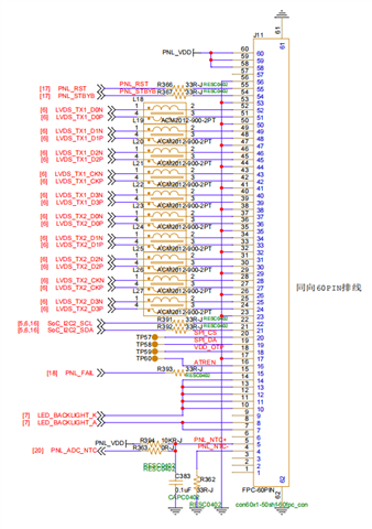

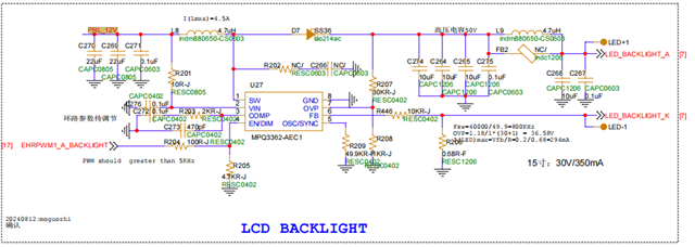

Hardware circuit design:

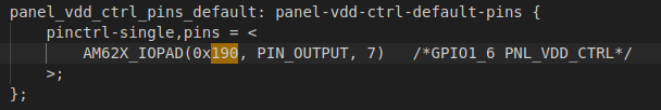

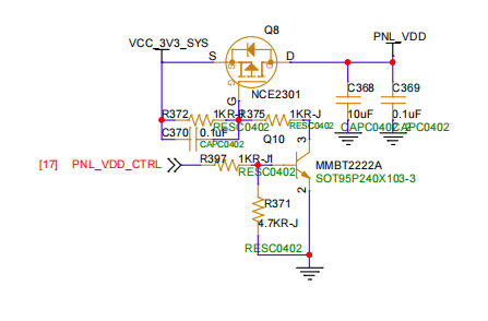

PNL_VDD_CTRL is connected to the SOC AB20 (GPO1_6) pin
PNL_BackLight_CTRL is connected to SOC AA21 (GPO1_3) pin

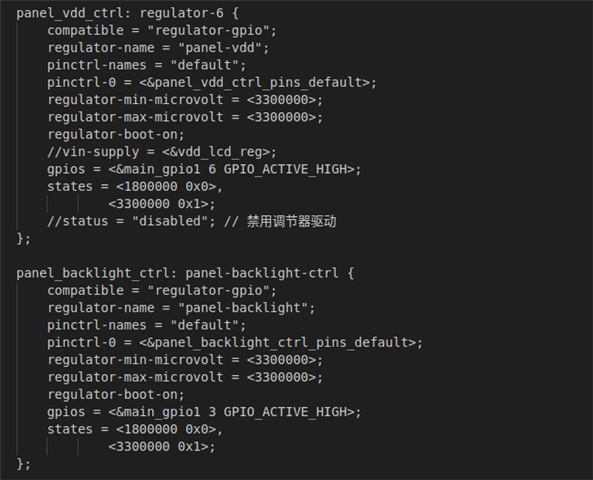

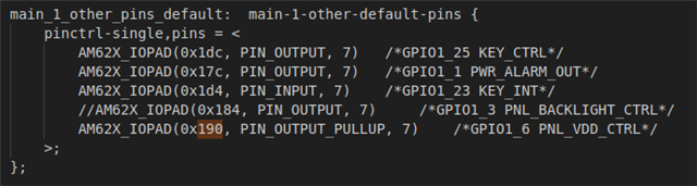

device tree
After power on, the PNL_VDD_CRL and PNL_BackLight_CTRL pins will be pulled high

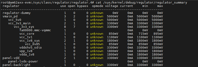

Board side view GPIO status and regulator status commands
cat /sys/kernel/debug/gpio
cat /sys/kernel/debug/regulator/regulator_summary

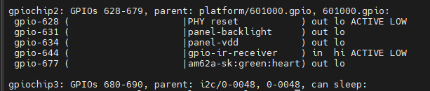

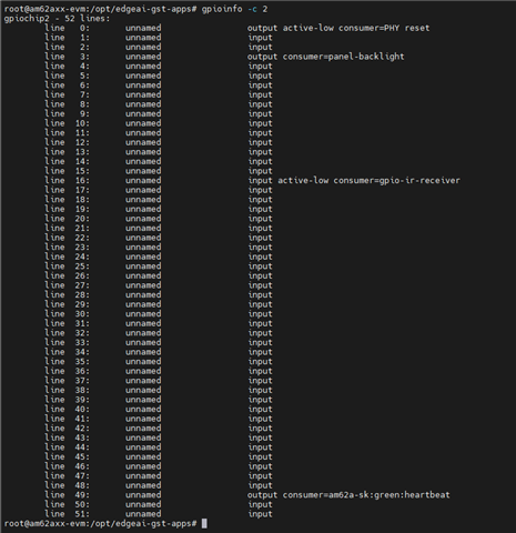

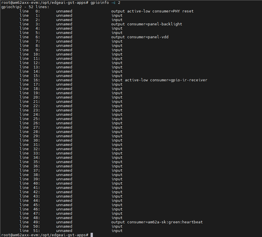

    The device tree nodes claim the regulator-gpio as the consumer of the GPIO, not userspace. Hence userspace will return the devices as busy because its expecting the regulator-gpio and its relevant driver to control this GPIO.
    You can run 'gpioinfo -c 2' to confirm this.
    Anshu
    Yes, in the current configuration where the gpio pin is set to regulator-6, entering the gpioinfo - c2 command will show that the GPIO pin is occupied by panel vdd.
    At this time, if you enter echo xxx or gpioset/gpioget related commands, an error message "Device or resource busy" will appear.

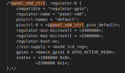

    However, if I change the configuration of this pin in the device tree to the following way.
    It is possible to lower the pin by using echo xxx or gpioset/gpioget related commands while ensuring that the pin is powered on and defaults to a high level.
    Why are the results of these two ways of setting GPIO so different? I want to know the specific reasons for this.
    Garett
  • Hi Garett,
    Its just dependent on the consumer of the GPIO. If its assigned a consumer, its expected its respective driver to update the signal.
