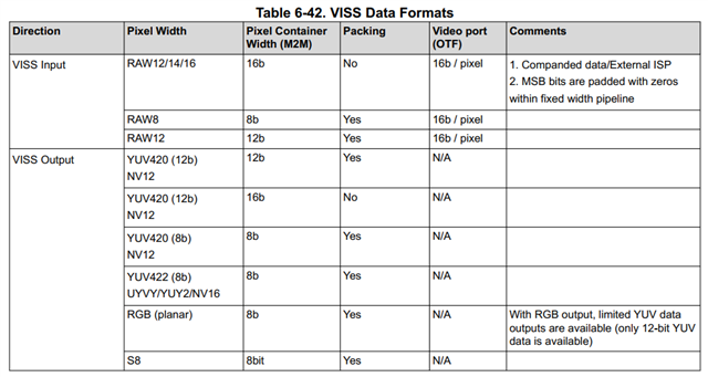

Currently, the VISS node of the TDA4 VH platform outputs in yuv nv12 format. Could you please tell me if it is possible to output in UYVY format, and how to set it up?

You have to change the openvx image format to yuyv and change the mux_output2 = 5 in the viss_params.
you can refer to this file $(psdkra)/imaging/kernels/include/TI/hwa_vpac_viss_fcp.h for the config values.
