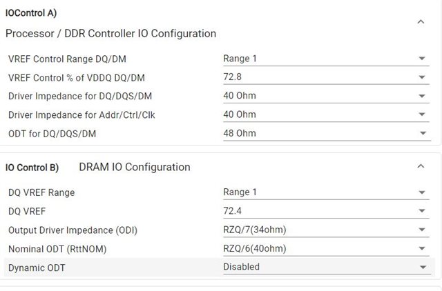

  • Hi JJD,
    What parameters we need to modify in the DDR4 SysConfig settings for the 50 Ω trace impedance?
    Below are the default settings of the SysConfig DDR Configuration 0.10.32:
  • You would focus on the driver impedance and ODT settings. for both controller and DRAM.  Most likely you would set those to 48ohm each, but you may have to tweak those based on manufacturing tolerances.
    James
