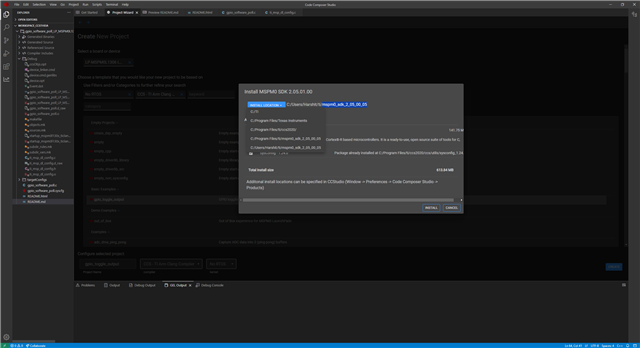

Hi TI CCS Experts (this post is intended to CCS Developers),
I already have MSP M0 L1306 SDK installed on my system. But, I am unable to use it to start a fresh project on CCS Studio Theia v20.0.2.
Even when trying to proceed with an installation, I am unable to customize the installation location from the pop-up. It just provides me some pre-filled path that can be used.
Please fix it in this tool.
  • Harshit,
    The list of paths shown in that dialog are the list of paths that CCS is looking for SDKs in. This dialog does not currently allow you to add additional paths.  You can modify this list by going to Settings -> Code Composer Studio Settings.  Then select General -> Products on the left.
    You can click the + button to add a new location to look for SDKs.  This new path will then be available as an install location.

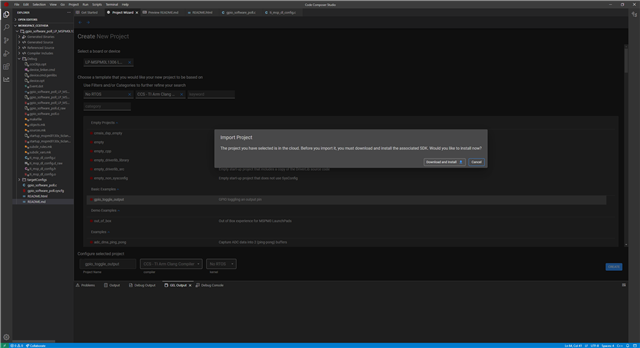

  • Thanks John on recommending the setting that can allow me to choose an appropriate installation location for a fresh SDK installation.
    But the other half of this issue still remains, as it is not able to use my existing SDK installation from this path. Can this feature be supported on CCS Theia to detect or input an existing installation path for starting a new CCS project from its menu?
    Harshit
  • Unfortunately the wizard is stuck using the latest SDK.  There is an enhancement request open to let you select the version and to default to the latest version that is installed.
    One thing you can do is use the Resource Explorer tree instead.  View -> Resource Explorer.
    Go to the SDK
    The click the 3 dots and select manage versions.  You can then choose which versions you want to show up.
    I selected to also see the 2.00.01.00 version and now it is also in the tree.
    You can then expand that and choose the example you want to import.
