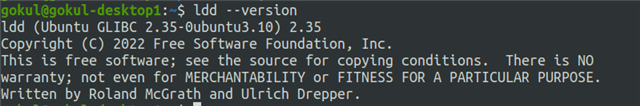

    1. Can you please tell me the ldd --version of your working Ubuntu 22.04 env.  (I have glibc 2.35 for ubuntu 22.04)
    2. Can you please tell me the output of  "${PSDKRA_PATH}/toolchain/sysroots/x86_64-arago-linux/usr/bin/aarch64-oe-linux/aarch64-oe-linux-gcc --version "
    in your working environment.
    So far I still have the glibc mismatch.
    Asif
  • Hi Asif,
    attaching ldd and gcc version
    Gokul
  • Hello Gokul,
    Thank you very much for your reply, this was very helpful
    Kind regards
    Asif
