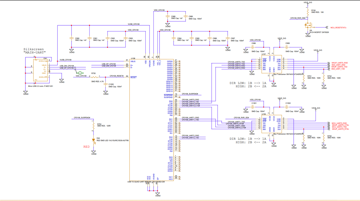

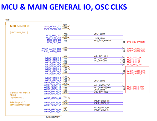

  • HI Gokul :
    These are my hardware schematics of UART
    Thanks and Best Regards
  • Hi Andrew,
    Thanks for providing the schematic. Can you please specify which UART port you are attempting to use?
    EDIT: And could you also provide schematic to the bootmode pins?

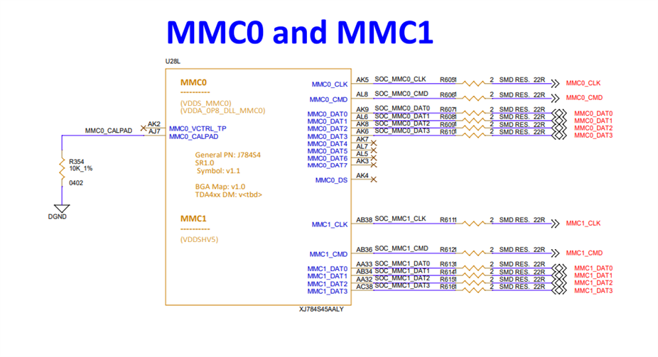

  • HI Mark
    I am going to use U159 to connect  to SOC(AM69) .Here is the capture of circuit .Sorry i got a wrong picture before.
    And here is the schematic of the bootmode pins .I don't use CPLD but use register to config the   bootmode pins .According to the document "top_cpld_j7ahp_sk".I set MCU_BOOTMODE3,4,5 ->HIGH,and SYS_BOOTMODE0,4,6->LOW to enter the uart mode.
  • The BootROM does not use HW flow control – so TX/RX should be sufficient.
    MCU_UART0 and WKUP_UART0 might be available on several different pin locations.  But BootROM requires specific pin locations for booting:
    Pins J37, K38 for MCU_UART0, Pins K35, K34 for WKUP_UART0.  This appears correct on schematic.

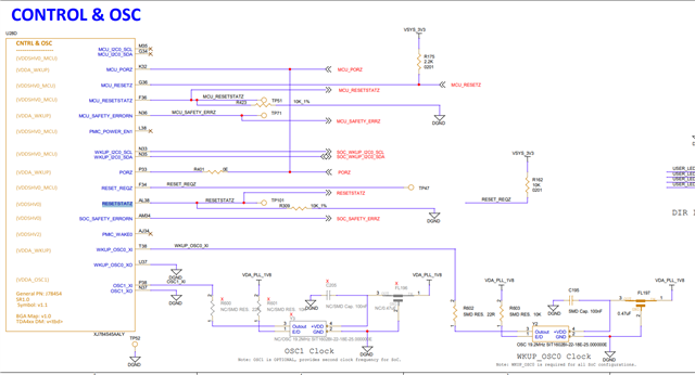

    Have you verified the device is existing reset?  MCU_RESESTATz and RESETSTATz should both be '1' (high).
  • HI Robert
    According schematics ,I have got 3.3v on MCU_RESETZ and RESETSTATZ.
  • Andrew, did you mean you are measuring 3.3V when probing TP51 (MCU_RESETSTATZ) and TP101 (RESETSTATZ)?
    If yes, the device should have exited reset; can you try NO BOOT mode and check if you can connect to the device through CCS?

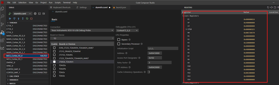

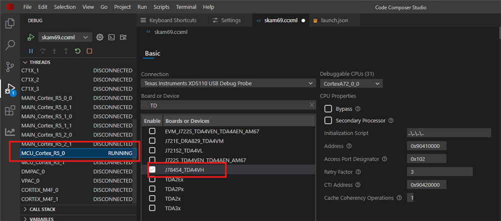

    Thanks for your reply.Yes ,i have 3.3v when probing TP51 (MCU_RESETSTATZ) and TP101 (RESETSTATZ) on my custom board, But I don't have debug tool like  XDS110 JTAG Debug Probe right now ,i will buy one as soon as possible ,but i have one evb board  sk-am69 right now  . I want to figure out the behavior when i connect  to AM69  through CCS  .i am going to connect AM69 through on-board XDS110 of EVB SK-AM69.
    First ,I followed your instructions ,I config the  EVB SK-AM69 as no boot mode using SW2 and connect to CCS. Here have few qusetions
    1. I have not see AM69x or SK-AM69 on the device list  .so i choose J784S4_TDA4VH ,am i doing right? I have connected MCU_Cortex_R5_0 successfully
    2. When i pause MCU_Cortex_R5_0,there have many registers on the right side , which one shoud i check first if i can't see cccc in uart boot mode ?
  • Hi Andrew,
    Yes, I believe this is fine.

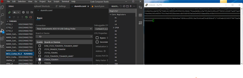

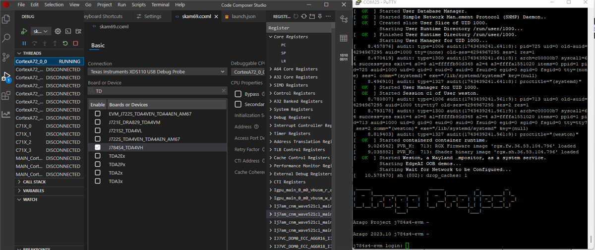

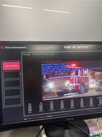

  • HI Mark
    Yes, I can see CCCC when I opened Putty in UART BOOT mdoe. I also can boot SK-AM69 with SD card in  SD card mdoe.
    1.UART BOOT mdoe
    1.SD card mdoe
