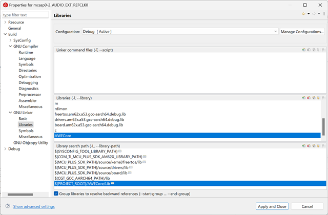

  • Sorry, AWECore is not needed. You can simply remove it from the property link.
  • I recreated the project to try again. If you still encounter an error saying that 'AWECore/lib' cannot be found, please remove the AWECore-related linker settings from Properties > Build > GNU Linker > Libraries.
