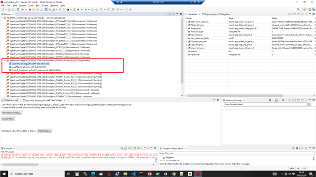

TDA4VH-Q1: After enabling ENABLE_DSS_SINGLE in MCU20, the initialization failed.
Part Number: TDA4VH-Q1
Other Parts Discussed in Thread: TDA4VH
TDA4VH custom board
SDK 11.0
linux+freertos
When we disabled ENABLE_DSS_SINGLE, the initialization of MCU20 was normal. The log is as follows

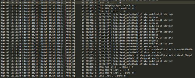

When we enabled ENABLE_DSS_SINGLE, the initialization of MCU20 failed. It seems that it crashed during the initialization process.The log is as follows

Mar 05 15:13:34 tda4vh-dt2vh tda4vh-dt2vh[696]: [MCU2_0]     13.262428 s: DSS: Init ... !!!
Mar 05 15:13:34 tda4vh-dt2vh tda4vh-dt2vh[696]: [MCU2_0]     13.262445 s: DSS: Display type is eDP !!!
Mar 05 15:13:34 tda4vh-dt2vh tda4vh-dt2vh[696]: [MCU2_0]     13.262463 s: DSS: M2M Path is enabled !!!
Mar 05 15:13:34 tda4vh-dt2vh tda4vh-dt2vh[696]: [MCU2_0]     13.262481 s: DSS: SoC init ... !!!
Mar 05 15:13:34 tda4vh-dt2vh tda4vh-dt2vh[696]: [MCU2_0]     13.262498 s: SCICLIENT: Sciclient_pmSetModuleState module=218 state=0
Mar 05 15:13:34 tda4vh-dt2vh tda4vh-dt2vh[696]: [MCU2_0]     13.262552 s: SCICLIENT: Sciclient_pmSetModuleState success
Mar 05 15:13:34 tda4vh-dt2vh tda4vh-dt2vh[696]: [MCU2_0]     13.262576 s: SCICLIENT: Sciclient_pmSetModuleState module=404 state=2
Mar 05 15:13:34 tda4vh-dt2vh tda4vh-dt2vh[696]: [MCU2_0]     13.262700 s: SCICLIENT: Sciclient_pmSetModuleState success
Mar 05 15:13:34 tda4vh-dt2vh tda4vh-dt2vh[696]: [MCU2_0]     13.262722 s: SCICLIENT: Sciclient_pmSetModuleState module=217 state=2
Mar 05 15:13:34 tda4vh-dt2vh tda4vh-dt2vh[696]: [MCU2_0]     13.262808 s: SCICLIENT: Sciclient_pmSetModuleState success
Mar 05 15:13:34 tda4vh-dt2vh tda4vh-dt2vh[696]: [MCU2_0]     13.262830 s: SCICLIENT: Sciclient_pmSetModuleState module=404 state=2
Mar 05 15:13:34 tda4vh-dt2vh tda4vh-dt2vh[696]: [MCU2_0]     13.262880 s: SCICLIENT: Sciclient_pmSetModuleState success
Mar 05 15:13:34 tda4vh-dt2vh tda4vh-dt2vh[696]: [MCU2_0]     13.262950 s: SCICLIENT: Sciclient_pmSetModuleState module=217 state=2
Mar 05 15:13:34 tda4vh-dt2vh tda4vh-dt2vh[696]: [MCU2_0]     13.263011 s: SCICLIENT: Sciclient_pmSetModuleState success
Mar 05 15:13:34 tda4vh-dt2vh tda4vh-dt2vh[696]: [MCU2_0]     13.263035 s: SCICLIENT: Sciclient_pmSetModuleState module=218 state=0
Mar 05 15:13:34 tda4vh-dt2vh tda4vh-dt2vh[696]: [MCU2_0]     13.263085 s: SCICLIENT: Sciclient_pmSetModuleState success
Mar 05 15:13:34 tda4vh-dt2vh tda4vh-dt2vh[696]: [MCU2_0]     13.263108 s: SCICLIENT: Sciclient_pmSetModuleClkFreq module=218 clk=3 freq=148500000
Mar 05 15:13:34 tda4vh-dt2vh tda4vh-dt2vh[696]: [MCU2_0]     13.263211 s: SCICLIENT: Sciclient_pmSetModuleClkFreq success
Mar 05 15:13:34 tda4vh-dt2vh tda4vh-dt2vh[696]: [MCU2_0]     13.263235 s: SCICLIENT: Sciclient_pmModuleClkRequest module=218 clk=3 state=2 flag=2
Mar 05 15:13:34 tda4vh-dt2vh tda4vh-dt2vh[696]: [MCU2_0]     13.263313 s: SCICLIENT: Sciclient_pmModuleClkRequest success
Mar 05 15:13:34 tda4vh-dt2vh tda4vh-dt2vh[696]: [MCU2_0]     13.263337 s: SCICLIENT: Sciclient_pmSetModuleState module=218 state=2
Mar 05 15:13:34 tda4vh-dt2vh tda4vh-dt2vh[696]: [MCU2_0]     13.263433 s: SCICLIENT: Sciclient_pmSetModuleState success
Mar 05 15:13:34 tda4vh-dt2vh tda4vh-dt2vh[696]: [MCU2_0]     13.263455 s: DSS: SoC init ... Done !!!
Mar 05 15:13:34 tda4vh-dt2vh tda4vh-dt2vh[696]: [MCU2_0]     13.263474 s: DSS: Board init ... !!!
Mar 05 15:13:34 tda4vh-dt2vh tda4vh-dt2vh[696]: [MCU2_0]     13.263492 s: DSS: Board init ... Done !!!
Mar 05 15:13:34 tda4vh-dt2vh tda4vh-dt2vh[696]: [MCU2_0]     13.281607 s: DSS: Init ... Done !!!
