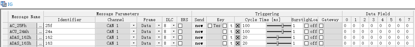

2.When debugging the CAN transceiver of TDA4VEN, I encountered an issue: when transmitting and receiving messages simultaneously on the same CAN bus, frame loss occurs during message transmission. The transmission is using the buffer method and receive is using the fifo0.Additionally, the return value of MCAN_txBufAddReq() is normal.
2.1 The CAN baud rate is 500k and the sampling point is 80%
3.vt_can.c and vt_can.h codes are as follows
3.1. The entry function of vt_can.c is int32_t vtcan_init (void), the can send function is int32_t vtcan_txmsg (stCANTypeMsgBaseInfo TxMsgInfo, uint8_t TxMsgBufNum), and the can interrupt is void vtcan_mcan0IntrISR (void *arg)

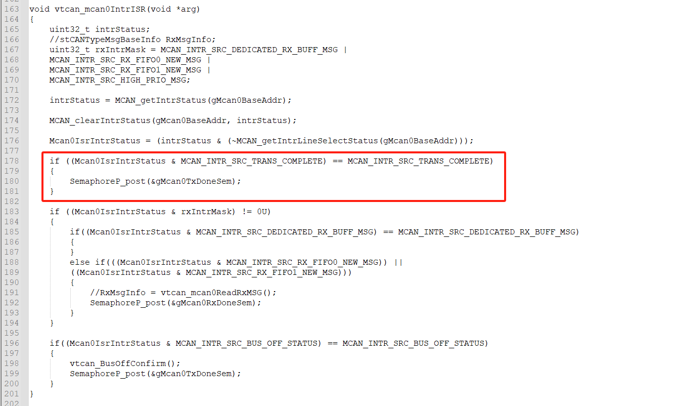

void vtcan_mcan0IntrISR(void *arg)
    uint32_t intrStatus;
    //stCANTypeMsgBaseInfo RxMsgInfo;
    uint32_t rxIntrMask = MCAN_INTR_SRC_DEDICATED_RX_BUFF_MSG |
    MCAN_INTR_SRC_RX_FIFO0_NEW_MSG |
    MCAN_INTR_SRC_RX_FIFO1_NEW_MSG |
    MCAN_INTR_SRC_HIGH_PRIO_MSG;
    intrStatus = MCAN_getIntrStatus(gMcan0BaseAddr);
    MCAN_clearIntrStatus(gMcan0BaseAddr, intrStatus);
    Mcan0IsrIntrStatus = (intrStatus & (~MCAN_getIntrLineSelectStatus(gMcan0BaseAddr)));
    if ((Mcan0IsrIntrStatus & MCAN_INTR_SRC_TRANS_COMPLETE) == MCAN_INTR_SRC_TRANS_COMPLETE)
        SemaphoreP_post(&gMcan0TxDoneSem);
    if ((Mcan0IsrIntrStatus & rxIntrMask) != 0U)
        if((Mcan0IsrIntrStatus & MCAN_INTR_SRC_DEDICATED_RX_BUFF_MSG) == MCAN_INTR_SRC_DEDICATED_RX_BUFF_MSG)
        else if(((Mcan0IsrIntrStatus & MCAN_INTR_SRC_RX_FIFO0_NEW_MSG)) ||
        ((Mcan0IsrIntrStatus & MCAN_INTR_SRC_RX_FIFO1_NEW_MSG)))
            //RxMsgInfo = vtcan_mcan0ReadRxMSG();
            SemaphoreP_post(&gMcan0RxDoneSem);
    if((Mcan0IsrIntrStatus & MCAN_INTR_SRC_BUS_OFF_STATUS) == MCAN_INTR_SRC_BUS_OFF_STATUS)
        vtcan_BusOffConfirm();

4.If you receive more than 3 messages sent consecutively by different CANIDs with different periods,the CAN transmission will lose frames. At the same time, the message ID to be received is also vt_can.c.(line 314)
In addition, when the CAN transmission is found to be lost, the CAN transmission completion interrupt (the code in the red box in the figure below) is not entered. However, receiving messages is normal.

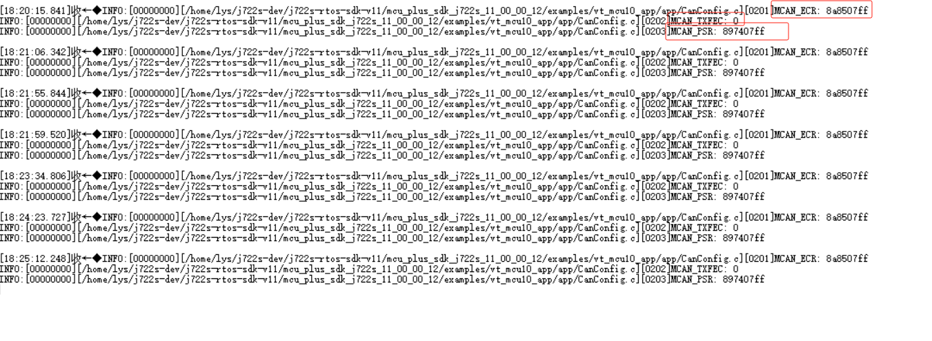

    2.When frame loss occurs, the print records of MCAN_ECR, MCAN_TXEFC, and MCAN_PSR are as follows

    3.As mentioned above, whenever there is a frame loss, MCAN_ECR=0x8a8507ff、MCAN_TXFEC=0、MCAN_PSR=0x897407ff

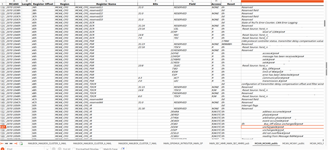

    Based on Your MCAN_PSR register status , the CAN node went into bus off status .If CAN node enters into Busoff status then only 2 ways are possible either you need to recover from software by writing recovery mechanism or doing reset of hardware.
    Can you check why there is bus off triggered in your system , is it due to issue with Acknowledgement from other node or any other reasons ?
    Tarun Mukesh

    This MCAN_PSR is saying there is bus off in the system and ECR is showing high count of retransmission.

    #define MCAN_ECR                                           (0x40U)
    #define MCAN_PSR                                           (0x44U)
    #define MCAN_TXEFC                                       (0xf0U)

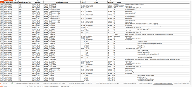

    Can you please read CAN instance core register  MCAN_ECR MCAN_TXEFC and MCAN_PSR ?
    Tarun Mukesh
    We are currently using this set of CAN, not the register address you sent, right?
    If it MCU_MCAN0 then it is as below
    Tarun Mukesh

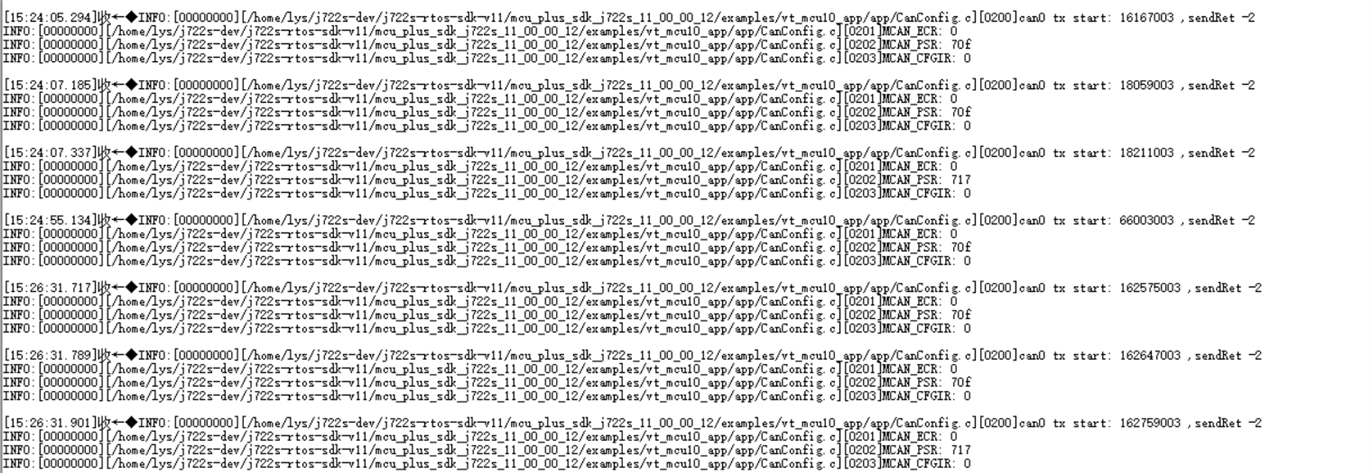

    1.As shown in the figure below, when a frame loss occurs during CAN transmission, MCU_CAN_PSR=0x70F or MCU_CAN_PSR=0x717.
    2.When the host receives the following message sent by canoe, MCU_CN_PSR will report an error. If the host receives more than 120 frames of messages within 1 second, MCU_CN_PSR will report an error.
    Thanks!
    This shows no errors. 0x70F means CAN node is idle and 0x717 means CAN nodes is operating as receiver.
