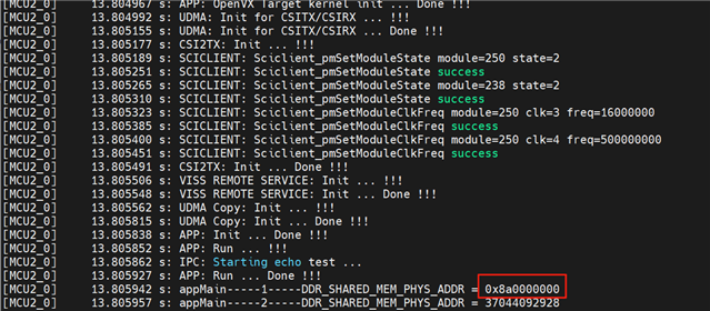

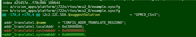

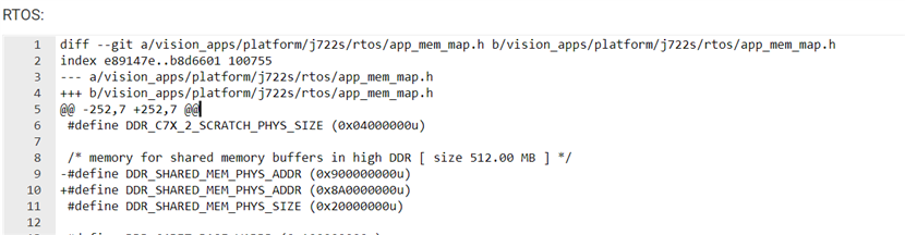

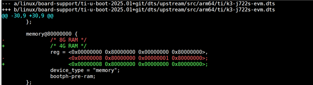

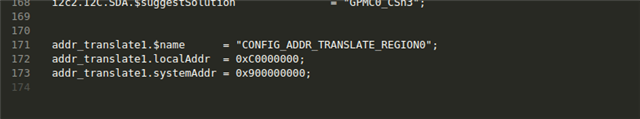

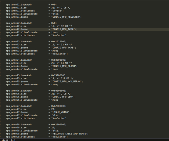

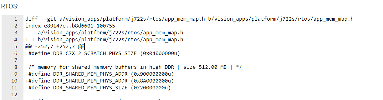

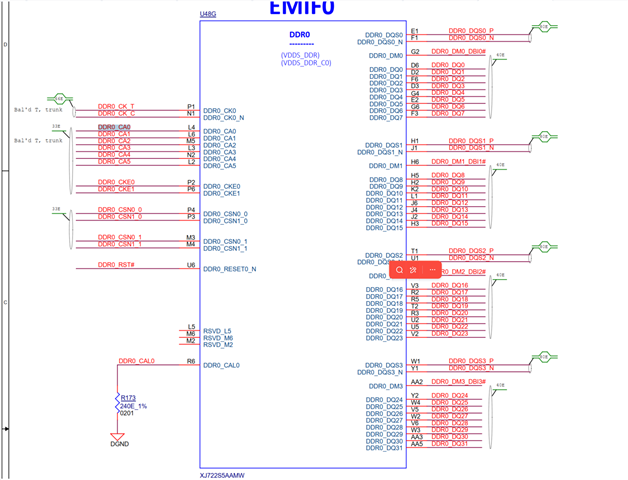

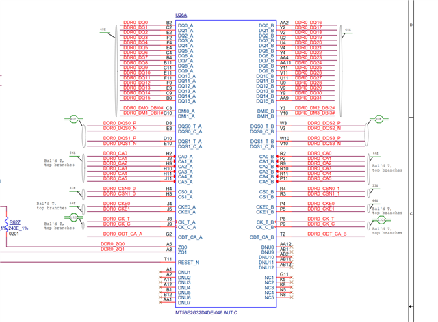

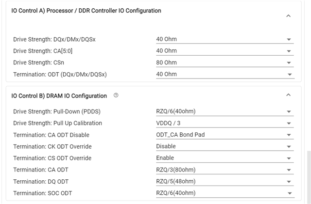

TDA4VEN-Q1: DDR-4GB debug
Part Number: TDA4VEN-Q1

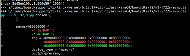

modify DDR SIZE to 4GB
error log:
NOTICE:  BL31: v2.12.0(release):11.00.09-dirty
NOTICE:  BL31: Built : 12:35:58, Mar 24 2025
U-Boot SPL 2025.01-ti (Jul 28 2025 - 20:48:01 +0800)
SYSFW ABI: 4.0 (firmware rev 0x000b '11.0.9--v11.00.09+ (Fancy Rat)')
Trying to boot from MMC2
mmc_load_image_raw_sector: mmc block read error
Authentication passed
i2c_write: error waiting for data ACK (status=0x116)
pca953x gpio@23: Error reading output register
pca953x gpio@20: Error reading output register
U-Boot 2025.01-ti (Jul 28 2025 - 20:48:01 +0800)
SoC:   J722S SR1.0 HS-FS
Model: Texas Instruments J722S EVM
DRAM:  2 GiB (total 4 GiB)
Core:  104 devices, 30 uclasses, devicetree: separate
MMC:   mmc@fa10000: 0, mmc@fa00000: 1
Loading Environment from nowhere... OK
In:    serial@2800000
Out:   serial@2800000
Err:   serial@2800000
Net:   eth0: ethernet@8000000port@1
Hit any key to stop autoboot:  0
switch to partitions #0, OK
mmc1 is current device
________________________________SD/MMC found on device 1
1022 bytes read in 3 ms (332 KiB/s)
Loaded env from uEnv.txt
Importing environment from mmc1 ...
Running uenvcmd ...
Failed to load '/lib/firmware/j722s-mcu-r5f0_0-fw'
625536 bytes read in 50 ms (11.9 MiB/s)
Warning: Did not detect image signing certificate. Skipping authentication to prevent boot failure. This will fail on Security Enforcing(HS-SE) devices
Load Remote Processor 2 with data@addr=0x82000000 625536 bytes: Success!
11804840 bytes read in 249 ms (45.2 MiB/s)
Load Remote Processor 3 with data@addr=0x82000000 11804840 bytes: Success!
11804840 bytes read in 250 ms (45 MiB/s)
Load Remote Processor 4 with data@addr=0x82000000 11804840 bytes: Success!
22258176 bytes read in 924 ms (23 MiB/s)
80025 bytes read in 7 ms (10.9 MiB/s)
Working FDT set to 88000000
6490 bytes read in 4 ms (1.5 MiB/s)
2883 bytes read in 4 ms (703.1 KiB/s)
## Flattened Device Tree blob at 88000000
   Booting using the fdt blob at 0x88000000
   Loading Device Tree to 000000008fee9000, end 000000008fffffff ... OK
Working FDT set to 8fee9000
Starting kernel ...

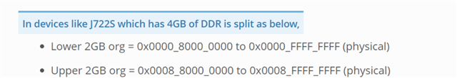

  • Hi Cesar,
    since our evm has 8GB ddr we have mapped it to high-order region, for custom modification you have to map every section within the available memory.
    please refer to this appnote for more info https://www.ti.com/lit/ab/spradp3/spradp3.pdf?ts=1739512337624&ref_url=https%253A%252F%252Fwww.ti.com%252Fproduct%252FTDA4VL-Q1%253FkeyMatch%253DTDA4VL-Q1%2526tisearch%253Dsearch-everything%2526usecase%253DGPN-ALT
    vision_apps_shared region is used by openvx applications where all buffers are allocated in this region.
    Gokul
  • Hi Gokul,

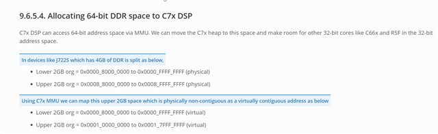

    The R5F also uses tiovx, but it can only access 32-bit addresses.
    Cesar
  • Hi Cesar,
    Yes, we have RAT(region based address translation) module to map 32 bit address to 40 bit address.
    by that way we could able to map to the upper ddr space.
    Gokul
  • Hi Gokul,

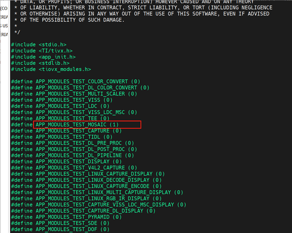

    The modify DDR4G tiovx test modification failed
    1. When the default DDR is 8GB, use tiovx mosaic test
    build & run
    It can run successfully.

    2. modify DDR size to 4GB:
    Linux:
    diff --git a/linux/board-support/ti-linux-kernel-6.12.17+git-ti/arch/arm64/boot/dts/ti/k3-j722s-evm.dts b/linux/board-support/ti-linux-kernel-6.12.17+git-ti/arch/arm64/boot/dts/ti/k3-j722s-evm.dts
    index 2d45ee109..0a00564a2 100644
    --- a/linux/board-support/ti-linux-kernel-6.12.17+git-ti/arch/arm64/boot/dts/ti/k3-j722s-evm.dts
    +++ b/linux/board-support/ti-linux-kernel-6.12.17+git-ti/arch/arm64/boot/dts/ti/k3-j722s-evm.dts
    @@ -32,9 +32,9 @@ chosen {
            memory@80000000 {
    -               /* 8G RAM */
    +               /* 4G RAM */
                    reg = <0x00000000 0x80000000 0x00000000 0x80000000>,
    -                     <0x00000008 0x80000000 0x00000001 0x80000000>;
    +                     <0x00000008 0x80000000 0x00000000 0x80000000>;
                    device_type = "memory";
                    bootph-pre-ram;
    diff --git a/linux/board-support/ti-linux-kernel-6.12.17+git-ti/arch/arm64/boot/dts/ti/k3-j722s-rtos-memory-map.dtsi b/linux/board-support/ti-linux-kernel-6.12.17+git-ti/arch/arm64/boot/dts/ti/k3-j722s-rtos-memory-map.dtsi
    index 1e79eef6a..787f43f9a 100644
    --- a/linux/board-support/ti-linux-kernel-6.12.17+git-ti/arch/arm64/boot/dts/ti/k3-j722s-rtos-memory-map.dtsi
    +++ b/linux/board-support/ti-linux-kernel-6.12.17+git-ti/arch/arm64/boot/dts/ti/k3-j722s-rtos-memory-map.dtsi
    @@ -130,7 +130,7 @@ c7x_ddr_heaps_hi: c7x-ddr-heaps-hi@880000000 {
            vision_apps_shared_region: vision_apps_shared-memories {
                    compatible = "dma-heap-carveout";
    -               reg = <0x09 0x00000000 0x00 0x20000000>;
    +               reg = <0x08 0xa0000000 0x00 0x20000000>;
         linux,cma {
             status = "disabled";
    @@ -138,7 +138,7 @@ linux,cma {
         linux_cma_region: linux-cma-buffers@980000000 {
             compatible = "shared-dma-pool";
             reusable;
    -        reg = <0x09 0x80000000 0x00 0x38000000>;
    +        reg = <0x08 0xc0000000 0x00 0x38000000>;
             linux,cma-default;
    diff --git a/linux/board-support/ti-u-boot-2025.01+git/dts/upstream/src/arm64/ti/k3-j722s-evm.dts b/linux/board-support/ti-u-boot-2025.01+git/dts/upstream/src/arm64/ti/k3-j722s-evm.dts
    index 6a6d903d7..935f033a8 100644
    --- a/linux/board-support/ti-u-boot-2025.01+git/dts/upstream/src/arm64/ti/k3-j722s-evm.dts
    +++ b/linux/board-support/ti-u-boot-2025.01+git/dts/upstream/src/arm64/ti/k3-j722s-evm.dts
    @@ -30,9 +30,9 @@
            memory@80000000 {
    -               /* 8G RAM */
    +               /* 4G RAM */
                    bootph-pre-ram;
    update dtb;

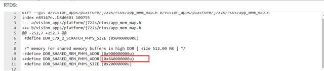

    RTOS:
    diff --git a/vision_apps/platform/j722s/rtos/app_mem_map.h b/vision_apps/platform/j722s/rtos/app_mem_map.h
    index e89147e..b8d6601 100755
    --- a/vision_apps/platform/j722s/rtos/app_mem_map.h
    +++ b/vision_apps/platform/j722s/rtos/app_mem_map.h
    @@ -252,7 +252,7 @@
     #define DDR_C7X_2_SCRATCH_PHYS_SIZE (0x04000000u)
     /* memory for shared memory buffers in high DDR [ size 512.00 MB ] */
    -#define DDR_SHARED_MEM_PHYS_ADDR (0x900000000u)
    +#define DDR_SHARED_MEM_PHYS_ADDR (0x8A0000000u)
     #define DDR_SHARED_MEM_PHYS_SIZE (0x20000000u)
     #define DDR_64BIT_BASE_VADDR (0x100000000u)
    diff --git a/vision_apps/platform/j722s/rtos/gen_linker_mem_map.py b/vision_apps/platform/j722s/rtos/gen_linker_mem_map.py
    index 18a008d..e08ff62 100755
    --- a/vision_apps/platform/j722s/rtos/gen_linker_mem_map.py
    +++ b/vision_apps/platform/j722s/rtos/gen_linker_mem_map.py
    @@ -272,7 +272,7 @@ c7x_2_1_ddr_local_heap_addr = c7x_1_ddr_local_heap_addr;
     c7x_2_1_ddr_scratch_addr = c7x_1_ddr_scratch_addr;
     # Shared memory for DMA Buf FD carveout (located in high mem)
    -ddr_shared_mem_addr_phys  = 0x900000000;
    +ddr_shared_mem_addr_phys  = 0x8a0000000;
     # Create memory section based on addr and size defined above, including
    diff --git a/vision_apps/platform/j722s/rtos/k3-j722s-rtos-memory-map.dtsi b/vision_apps/platform/j722s/rtos/k3-j722s-rtos-memory-map.dtsi
    index a9af97f..6657a45 100644
    --- a/vision_apps/platform/j722s/rtos/k3-j722s-rtos-memory-map.dtsi
    +++ b/vision_apps/platform/j722s/rtos/k3-j722s-rtos-memory-map.dtsi
    @@ -78,6 +78,6 @@
    make sdk;

    rebuild edgeai-tiovx-apps, run the tiovx mosaic test:
    root@j722s-evm:/opt/edgeai-tiovx-apps/build# cd ..
    root@j722s-evm:/opt/edgeai-tiovx-apps# ./bin/Release/edgeai-tiovx-apps-test
    APP: Init ... !!!
       344.487537 s: MEM: Init ... !!!
       344.487714 s: MEM: Initialized DMA HEAP (fd=5) !!!
       344.487936 s: MEM: Init ... Done !!!
       344.487957 s: IPC: Init ... !!!
       344.542923 s: IPC: Init ... Done !!!
    REMOTE_SERVICE: Init ... !!!
    REMOTE_SERVICE: Init ... Done !!!
       344.549763 s: GTC Frequency = 200 MHz
    APP: Init ... Done !!!
       344.549961 s:  VX_ZONE_INFO: Globally Enabled VX_ZONE_ERROR
       344.549991 s:  VX_ZONE_INFO: Globally Enabled VX_ZONE_WARNING
       344.550002 s:  VX_ZONE_INFO: Globally Enabled VX_ZONE_INFO
       344.550953 s:  VX_ZONE_INFO: [tivxPlatformCreateTargetId:169] Added target MPU-0
       344.551338 s:  VX_ZONE_INFO: [tivxPlatformCreateTargetId:169] Added target MPU-1
       344.551744 s:  VX_ZONE_INFO: [tivxPlatformCreateTargetId:169] Added target MPU-2
       344.552074 s:  VX_ZONE_INFO: [tivxPlatformCreateTargetId:169] Added target MPU-3
       344.552116 s:  VX_ZONE_INFO: [tivxInitLocal:202] Initialization Done !!!
       344.552140 s:  VX_ZONE_INFO: Globally Disabled VX_ZONE_INFO
    Running mosaic module test
    The program is stuck and cannot proceed to the next step.

    Cesar
  • Hi Cesar,
    Is only mosaic test is failing at 4GB configuration or other tests are also failing ?
    Also can you check your rtos memory_map is configured according to 4GB configurations.
    Also can you run this command before running the app to get remote core logs,
    source ./opt/vision_apps/vision_apps_init.sh
    Gokul
  • Hi Gokul,

    root@j722s-evm:/opt/edgeai-gst-apps# /opt/vision_apps/vision_apps_init.sh
    root@j722s-evm:/opt/edgeai-gst-apps# [MCU2_0]      2.941668 s: CIO: Init ... Done !!!

    Cesar
  • Hi Gokul,

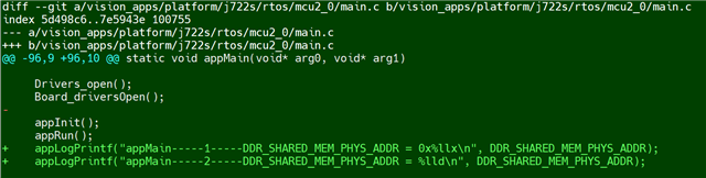

    Our customer feedback that this issue can be reproduced on EVM. Could you please help try customer's modification and check the phenomenon on EVM? Thank you
  • Hi Gokul,
      The value of the printed DDR SHARED MEM PHYS ADDR is consistent with the previously set value;
    Besides, our project is very urgent. Samples need to be produced on August 12th.
    We can ship the goods only after this issue has been dealt with. Please give us more support
    Cesar
  • make sdk;
    make linux_fs_install_sd
    with above change, mosaic test test result log:

       Semon
  • Hi Cesar,
    For j722s this macros will not have any effect in mpu config and RAT configs. You have to change the example.syscfg file.
    for example, mcu2_0 you need to modify $(psdkra)/vision_apps/platform/j722s/rtos/mcu2_0/example.syscfg
    you have to do mpu config in these configs,
    and the shared memory is configured here,
    you have to co-relate macro values inside this file and change accordingly.
    Gokul
  • Hi Gokul,
    1. Where is example.syscfg called and what is the target file;
    2. After the modification and compilation update, the phenomenon remains the same, the program will still get stuck.
    Cesar

         with these change, I can run 4G DDR on EVM, you can try.
    Linux:
        https://e2e.ti.com/cfs-file/__key/communityserver-discussions-components-files/791/k3_2D00_j722s_2D00_edgeai_2D00_apps.dtso
        https://e2e.ti.com/cfs-file/__key/communityserver-discussions-components-files/791/k3_2D00_j722s_2D00_rtos_2D00_memory_2D00_map.dtsi
        https://e2e.ti.com/cfs-file/__key/communityserver-discussions-components-files/791/k3_2D00_j722s_2D00_vision_2D00_apps.dtso
       https://e2e.ti.com/cfs-file/__key/communityserver-discussions-components-files/791/tisdk_2D00_ven_2D00_4Gmem_2D00_linux.patch
    uboot:
        https://e2e.ti.com/cfs-file/__key/communityserver-discussions-components-files/791/tisdk_2D00_uboot_2D00_diff.patch
    RTOS:
        vision_apps-platform-j722s-4Gmem.tar.gz
       Semon

  • Hi Cesar,
    The test was successfully modified through the above patches, but I have two questions to ask:
    Thanks   for giving this patch.
    1. Where an example.syscfg is called is not available;
    when you do "make vision_apps" this example.syscfg is used to generate the ti_dpl_config.c file inside vision_apps/platform/j722s/rtos/mcu2_0/generated/
    which will have the mpu config and RAT config and will be used to build mcu2_0 firmware. Similar goes for other remote cores as well.
    2. Why can the above patches pass the test without modifying the following files.
    Which files are you referring here ?
      can you please give the changes that is covered in your patch.
    Gokul
  • patch of Semon
    diff --git a/vision_apps/platform/j722s/rtos/c7x_1/example.syscfg b/vision_apps/platform/j722s/rtos/c7x_1/example.syscfg
    index be380533..3904cf64 100644
    --- a/vision_apps/platform/j722s/rtos/c7x_1/example.syscfg
    +++ b/vision_apps/platform/j722s/rtos/c7x_1/example.syscfg
    @@ -168,7 +168,7 @@ mmu_armv89.attribute         = "MAIR7";
     mmu_armv810.$name             = "DDR_SHARED_MEM";
     mmu_armv810.vAddr             = 0xC0000000;
    -mmu_armv810.pAddr             = 0x900000000;
    +mmu_armv810.pAddr             = 0x8A0000000;
     mmu_armv810.size              = 0x20000000;
     mmu_armv810.attribute         = "MAIR7";
    diff --git a/vision_apps/platform/j722s/rtos/c7x_2/example.syscfg b/vision_apps/platform/j722s/rtos/c7x_2/example.syscfg
    index 349243c2..a0d754b2 100644
    --- a/vision_apps/platform/j722s/rtos/c7x_2/example.syscfg
    +++ b/vision_apps/platform/j722s/rtos/c7x_2/example.syscfg
    index 18a008d5..0c99fc94 100755
    +ddr_shared_mem_addr_phys  = 0x8A0000000;
    diff --git a/vision_apps/platform/j722s/rtos/gen_linker_mem_map_safertos.py b/vision_apps/platform/j722s/rtos/gen_linker_mem_map_safertos.py
    index 2f5c1c5e..5449cf5f 100755
    --- a/vision_apps/platform/j722s/rtos/gen_linker_mem_map_safertos.py
    +++ b/vision_apps/platform/j722s/rtos/gen_linker_mem_map_safertos.py
    @@ -245,7 +245,7 @@ c7x_2_ddr_scratch_size     = 112*MB;
     c7x_core_heap_hi_size     += c7x_2_ddr_scratch_size
    -ddr_shared_mem_addr_phys  = 0x900000000; # TODO: Clean this up
    +ddr_shared_mem_addr_phys  = 0x8A0000000; # TODO: Clean this up
     ddr_shared_mem_size       = 512*MB;
    diff --git a/vision_apps/platform/j722s/rtos/mcu1_0/example.syscfg b/vision_apps/platform/j722s/rtos/mcu1_0/example.syscfg
    index 7802af16..188a387d 100644
    --- a/vision_apps/platform/j722s/rtos/mcu1_0/example.syscfg
    +++ b/vision_apps/platform/j722s/rtos/mcu1_0/example.syscfg
    @@ -110,4 +110,4 @@ debug_log.uartLog.WKUP_UART.TXD.$suggestSolution = "WKUP_UART0_TXD";
     addr_translate1.$name      = "CONFIG_ADDR_TRANSLATE_REGION0";
     addr_translate1.localAddr  = 0xC0000000;
    -addr_translate1.systemAddr = 0x900000000;
    +addr_translate1.systemAddr = 0x8A0000000;
    diff --git a/vision_apps/platform/j722s/rtos/mcu2_0/example.syscfg b/vision_apps/platform/j722s/rtos/mcu2_0/example.syscfg
    index d25457ef..f78c0861 100644
    --- a/vision_apps/platform/j722s/rtos/mcu2_0/example.syscfg
    +++ b/vision_apps/platform/j722s/rtos/mcu2_0/example.syscfg
    @@ -170,4 +170,4 @@ i2c2.I2C.SDA.$suggestSolution               = "GPMC0_CSn3";
    diff --git a/vision_apps/platform/j722s/rtos/mcu2_0/example_no_board_deps.syscfg b/vision_apps/platform/j722s/rtos/mcu2_0/example_no_board_deps.syscfg
    index ac752538..bcd3019f 100644
    --- a/vision_apps/platform/j722s/rtos/mcu2_0/example_no_board_deps.syscfg
    +++ b/vision_apps/platform/j722s/rtos/mcu2_0/example_no_board_deps.syscfg
    @@ -99,4 +99,4 @@ mpu_armv711.attributes         = "NonCached";
    But he didn't compile gen linker mem map.py, because the app_mem_map.h will change after compilation, as shown below
    Although the above modifications can also solve the problem,
    why doesn't this need to be changed, but MCU2.0 will call this header file.
    Cesar
  • Hi Cesar,
    You will need to change both the .syscfg file and app_mem_map.h file (which will be updated when you run the gen linker mem map.py), because these macros are used in address conversion api's
    and .syscfg is used to generate dpl files which does mpu configs.
    Gokul

  • Hi Gokul,
    1. The DDR mapping range for 4GB is as follows.
    What about the mapping range for 8GB
    Lower 2GB (0x8000_0000 ~ 0xFFFF_FFFF);
    Upper 6GB (0x8_8000_0000 ~ 0x9_FFFF_FFFF);
    LPDDR4 --> DDRSS --> split -> RAT ->R5F
    Is it like this flowing water
    2. I don't understand these two shared memory applications
    lower DDR share(DDR_SHARED_MEM_ADDR): 0x8c00_0000 512MB;
    upper DDR share(DDR_SHARED_MEM_PHYS_ADDR):0x8_a000_0000 512MB
    Cesar

  • Hi Cesar,
    1. Yes you are correct
    2. These are implemented as per tiovx framework requirement and it is not needed if you are not using tiovx framework.
    To understand this you need to understand the framework on how memory is populated across all the host and remote cores. It is kept in a way that changing macro values is sufficient for the system to work properly.
    for r5f DDR_SHARED_MEM_ADDR will be the (32bit) virtual address range which will be mapped to actual physical address (DDR_SHARED_MEM_PHYS_ADDR) using RAT.
    This is not the physical address when looking from r5f perspective.
    Gokul

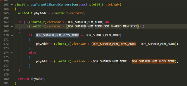

  • Hi Gokul,
    My question is:
    Now Both mcu2_0 and A53 linux will use vision apps shared-memories
    Multi-core heterogeneous management of this area(vision apps shared-memories)
    Cesar
  • Hi Cesar,
    Is this the new updated memory map ?
    because in default sdk vision_apps shared memory is mapped to 0X900000000.
    so linux will use 0x900000000 and rf5 will use RAT to map to the physical address.
    If in your updated memory map there are no 40 bit address and if your shared memory lies in the 32 bit region and you don't have to use RAT for address translation you can directly use that region provided you configure the mpu.
    Gokul
