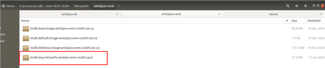

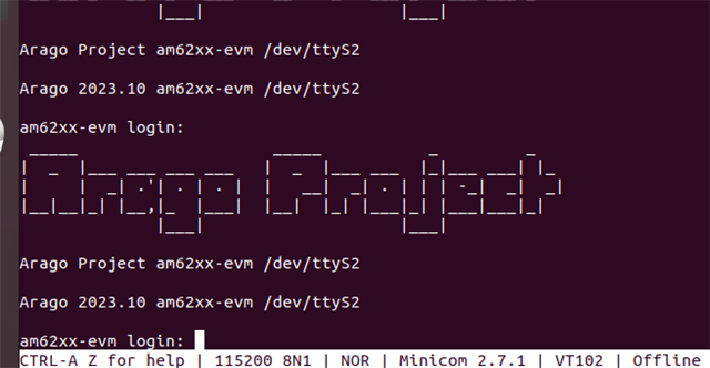

1. With the tiny-initramfs from TI Processor SDK 10.01.10.04
As the result, it goes to the log in console but stuck there. We cannot log in with user "root"

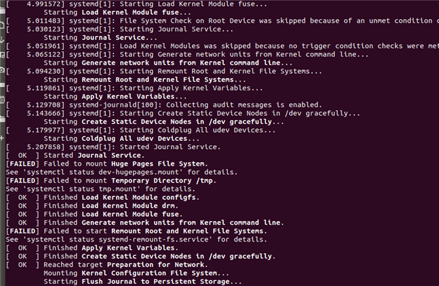

2. With the tiny-initramfs built from yocto
The tiny-initramfs that built from yocto have the different name and size in comparation with the prebuild one from TI SDK
When we use this tiny-initramfs, it failded to mount Huge Pages File System.
The strange thing is that when we tried to use the rootfs from another project that used the AM625, it worked well.
Could you let us know where we might be making a mistake?

    [    3.889749] Warning: unable to open an initial console.
    [    3.897238] Freeing unused kernel memory: 7808K
    [    3.901836] Run /init as init process
    [    4.604647] udevd[104]: starting version 3.2.14
    [    5.789732] random: crng init done
    [    5.799563] udevd[105]: starting eudev-3.2.14
     _____                    _____           _         _
    |  _  |___ ___ ___ ___   |  _  |___ ___  |_|___ ___| |_
    |     |  _| .'| . | . |  |   __|  _| . | | | -_|  _|  _|
    |__|__|_| |__,|_  |___|  |__|  |_| |___|_| |___|___|_|
                  |___|                    |___|
    Arago Project am62xx-evm /dev/ttyS2
    Arago 2023.10 am62xx-evm /dev/ttyS2
    am62xx-evm login: root
    login
     _____                    _____           _         _
                  |___|                    |___|
    am62xx-evm login: [   14.047345] OF: graph: no port node found in /bus@f0000/dss@30200000/oldi-txes/oldi@0/ports
    [   14.055821] OF: graph: no port node found in /bus@f0000/dss@30200000/oldi-txes/oldi@1/ports
    [   14.065640] platform 30200000.dss: deferred probe pending
    [   14.071076] platform regulator-2: deferred probe pending
    [   14.076395] platform 2b300050.target-module: deferred probe pending

    [    4.810119] systemd[1]: Mounting Huge Pages File System...
    [    4.826307] systemd[1]: POSIX Message Queue File System was skipped because of an unmet condition check (ConditionPathExists=/proc/sys/fs/mqueue).
    [    4.839940] systemd[1]: Kernel Debug File System was skipped because of an unmet condition check (ConditionPathExists=/sys/kernel/debug).
    [    4.852603] systemd[1]: Kernel Trace File System was skipped because of an unmet condition check (ConditionPathExists=/sys/kernel/tracing).
    [    4.868630] systemd[1]: Mounting Temporary Directory /tmp...
    [    4.886142] systemd[1]: Create List of Static Device Nodes was skipped because of an unmet condition check (ConditionFileNotEmpty=/lib/modules/6.6.58-ga7758da17c28-dirty/modules.devname).
    [    4.906997] systemd[1]: Starting Load Kernel Module configfs...
    [    4.926099] systemd[1]: Starting Load Kernel Module drm...
    [    4.946174] systemd[1]: Starting Load Kernel Module fuse...
    [    4.962129] systemd[1]: File System Check on Root Device was skipped because of an unmet condition check (ConditionPathIsReadWrite=!/).
    [    4.980821] systemd[1]: Starting Journal Service...
    [    4.998574] systemd[1]: Load Kernel Modules was skipped because no trigger condition checks were met.
    [    5.011783] systemd[1]: Starting Generate network units from Kernel command line...
    [    5.038307] systemd[1]: Starting Remount Root and Kernel File Systems...
    [    5.066106] systemd[1]: Starting Apply Kernel Variables...
    [    5.069377] systemd-journald[100]: Collecting audit messages is enabled.
    [    5.122410] systemd[1]: Starting Create Static Device Nodes in /dev gracefully...
    [    5.150047] systemd[1]: Starting Coldplug All udev Devices...
    [    5.174391] systemd[1]: Started Journal Service.
    [  OK  ] Started Journal Service.
    [FAILED] Failed to mount Huge Pages File System.
    See 'systemctl status dev-hugepages.mount' for details.
    [FAILED] Failed to mount Temporary Directory /tmp.
    See 'systemctl status tmp.mount' for details.
    [  OK  ] Finished Load Kernel Module configfs.
    [  OK  ] Finished Load Kernel Module drm.
    [  OK  ] Finished Load Kernel Module fuse.
    [  OK  ] Finished Generate network units from Kernel command line.
    [FAILED] Failed to start Remount Root and Kernel File Systems.
    See 'systemctl status systemd-remount-fs.service' for details.
    [  OK  ] Finished Apply Kernel Variables.
    [  OK  ] Finished Create Static Device Nodes in /dev gracefully.
    [  OK  ] Reached target Preparation for Network.
             Mounting Kernel Configuration File System...
             Starting Flush Journal to Persistent Storage...
             Starting Create System Users...
    [    5.498091] systemd-journald[100]: Received client request to flush runtime journal.
    [FAILED] Failed to mount Kernel Configuration File System.
    See 'systemctl status sys-kernel-config.mount' for details.
    [  OK  ] Finished Flush Journal to Persistent Storage.

             Starting Rule-based Manager for Device Events and Files...
    [FAILED] Failed to mount /var/volatile.
    See 'systemctl status var-volatile.mount' for details.
    [DEPEND] Dependency failed for Bind mount volatile /var/lib.
    [DEPEND] Dependency failed for Bind mount volatile /var/cache.
    [DEPEND] Dependency failed for Bind mount volatile /srv.
    [DEPEND] Dependency failed for Bind mount volatile /var/spool.
    [DEPEND] Dependency failed for Local File Systems.
    [  OK  ] Stopped Dispatch Password Requests to Console Directory Watch.
    [  OK  ] Stopped Forward Password Requests to Wall Directory Watch.
    [  OK  ] Reached target Timer Units.
    [  OK  ] Closed Syslog Socket.
    [  OK  ] Reached target Login Prompts.
             Starting Synchronize System and HW clocks...
             Starting Load/Save OS Random Seed...
    [  OK  ] Reached target Socket Units.
    [  OK  ] Started Emergency Shell.
    [  OK  ] Reached target Emergency Mode.
             Starting Rebuild Dynamic Linker Cache...
             Starting Create System Files and Directories...
    [  OK  ] Started Rule-based Manager for Device Events and Files.
    [FAILED] Failed to start Synchronize System and HW clocks.
    See 'systemctl status sync-clocks.service' for details.
    [  OK  ] Finished Rebuild Dynamic Linker Cache.
    [    6.609170] audit: type=1334 audit(1728487094.680:7): prog-id=11 op=LOAD
             Starting Network Configuration...
    [  OK  ] Finished Create System Files and Directories.
             Starting Rebuild Journal Catalog...
    [    6.792830] audit: type=1334 audit(1728487094.864:8): prog-id=12 op=LOAD
             Starting Network Name Resolution...
    [    6.816874] audit: type=1334 audit(1728487094.888:9): prog-id=13 op=LOAD
             Starting Network Time Synchronization...
             Starting Record System Boot/Shutdown in UTMP...
    [  OK  ] Started Network Configuration.
    [  OK  ] Finished Rebuild Journal Catalog.
             Starting Update is Completed...
    [  OK  ] Finished Record System Boot/Shutdown in UTMP.
             Starting Record Runlevel Change in UTMP...
    [  OK  ] Finished Update is Completed.
    [  OK  ] Finished Record Runlevel Change in UTMP.
    [  OK  ] Started Network Name Resolution.
    [  OK  ] Started Network Time Synchronization.
    [  OK  ] Reached target Network.
    [  OK  ] Reached target Host and Network Name Lookups.
    [  OK  ] Reached target System Time Set.
    [    7.453734] random: crng init done
    [  OK  ] Finished Load/Save OS Random Seed.
    You are in emergency mode. After logging in, type "journalctl -xb" Press Enter for maintenance
    (or press Control-D to continue):
    2. Log for tiny_initramfs from Yocto
