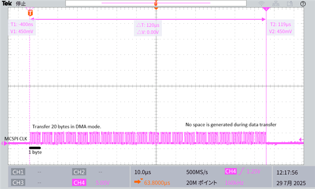

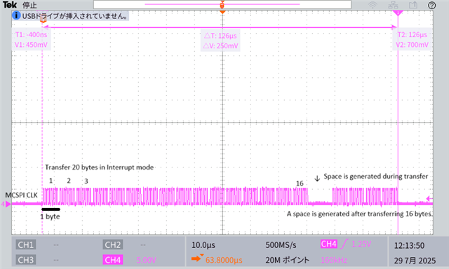

There is a difference in data transfer between MCSPI's DMA mode and Interrupt mode.
The SDK is mcu_plus_sdk_am64x_08_06_00_45.
20 bytes of data are transferred.

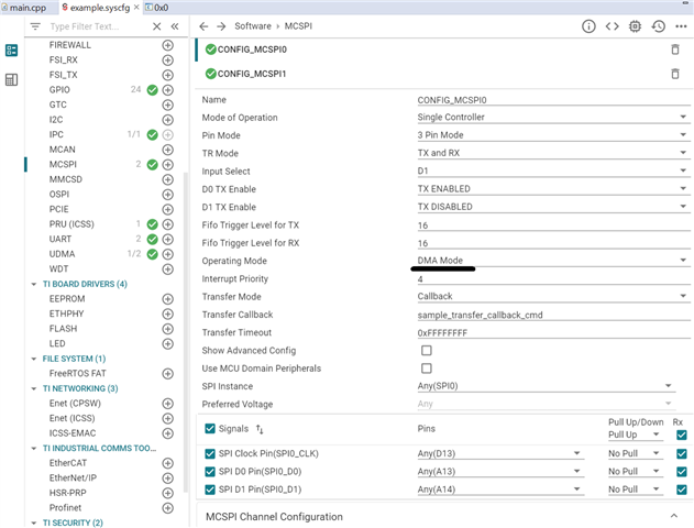

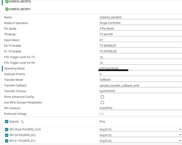

Attached are waveform images and settings images for data transfer in both modes.
In DMA mode, 20-byte transfers occur smoothly.
In Interrupt mode, there seems to be a wait after 16 bytes.
What could be the cause of this?
What settings are necessary to transfer data without waits in Interrupt mode?
By the way, when I changed the "Fifo Trigger Level for TX" in Interrupt mode from 16 to 32,
I confirmed that 20 bytes were transferred without any waiting time.
However, when I set the value to something other than 16 or 32, such as 20, the data was not even transferred.
Why is there no data transfer?

  • Regarding SysConfig:
    The values which you see for TX and RX Fifo Trigger level are to be selected as power of 2, since you are using older version hence the update is not seen on your end. The newer version has this update as can be seen below:
    For Interrupt mode:
    The data will be sent in chunks of Trigger level being set in the SysConfig, hence every interrupt which initiate the 16 bytes or x number of bytes where x is the TX Trigger level.
    Hence the split is seen in the waveform and is expected to be there.
    Let me know if you need any additional pointers on this, or you want me to refer you to the SW code where this is actually implemented.
