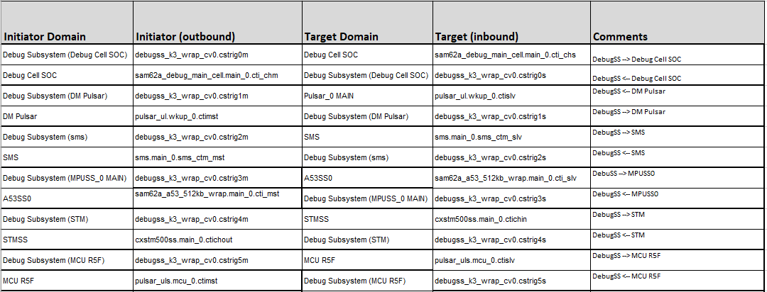

I'm looking for information about the CTI TRIGIN and TRIGOUT signals on the AM62P. I'm currently unable to configure the trace to start on a trigger, as it's unclear whether the ETM’s trigger signals are connected.
Could someone please clarify how the CTI triggers are connected for the MCU_R5, MAIN_R5, SMS_M4, and A53 cores?
