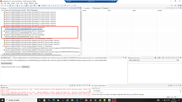

TDA4VH-Q1: After increasing the C7x memory to 512MB, the C7x program got stuck at the Mmu_addBlockEntry function.
Part Number: TDA4VH-Q1
Other Parts Discussed in Thread: TDA4VH
TDA4VH custom board
SDK 11.0
freertos+linux
When we modified the C7x heap memory in gen_linker_mem_map.py to 384MB, Linux, MCU and C7x all ran normally.
However, when we further increase the size to 512MB, all the C7x seem to get stuck in the Mmu_addBlockEntry function.We also modified the corresponding dts on the Linux side.
The modification of gen_linker_mem_map.py is as follows
The remote log is as follows

root@tda4vh-dt2vh:~#
The C7x call stack captured by CCS is as follows
