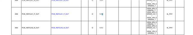

  • Hi Dave,
    Apologies for the delay.
    1.8V should be the logical high for that pin based on the datasheet:
    What I am seeing is the signal close to 1.8V, but slightly lower than 1.8V. I think this is due to the signal clocking at high frequency (1GHz) and not having enough time for the pin to go low.

  • Hi Takuma, thanks for the reply. I have two thoughts/questions.
    1. I had also noticed that the "I/O Voltage" shown in that table is 1.8 V, but here is where my confusion lies from an electrical perspective. When that pin is functioning as a SerDes reference clock, to the best of my understanding, it should be operating in a HCSL (High-Speed Current-Steering Logic) mode. This means that when the pin is "high" it should be driving ~14mA of current through whatever load is connected. In our case, we have a 50Ω resistor to ground connected. Therefore, the voltage that we should be measuring at the pin when it is "high" is V = IR = ~0.014 * 50 = ~0.7 V. Then, even if there is not enough time for the pin to go low, it should be hovering around 0.7 V, not 1.8 V.

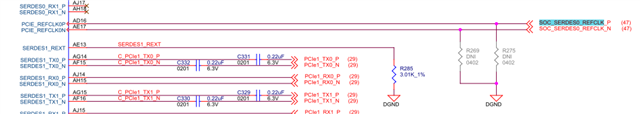

    For SK-AM69, still having some issues getting 100MHz measured on the scope. I connected directly to the test point, and looking through schematics, the lack of termination resistors may be the reason why I am seeing voltage at near 1.8V.

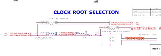

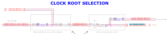

  • If wanting the SK-AM69 to be configured for the processor to generate the REFCLK in place of the on-board clock generator (For SERDE0 / PCIe0)
    1. install 50-ohm termination resistors near source (R269, R275).  They are 'not installed' by default:
    2. Change REFCLK resistor mux so that REFCLK from processor connects to PCIe peripheral (and on-board clock generator is not connected) (Remove R405, R407, R403, R404), Install 0-ohm (R406, R408, C657, C658)
    Similar can be done for SERDES1 / PCIe0 (see schematic for specific reference designators)
  • Hi , are you sure that is the SK-AM69 schematic? I have the latest from https://www.ti.com/lit/zip/SPRR466 and it does not match what you have shown; for example, R269 is on the BOARD ID EEPROM sheet, and R405 is under LDOs.
  • Sorry for the confusion - I was looking at a different design.  The SK-AM69 supports only REFCLK from the CDCI device.  The clocks are connected to the SERDES_REFCLK pins, no the PCIe_REFCLK pins (ACSPCIe pins)
    The CDCI device is programmable - can support both HCSL and LVDS outputs.  I thought it default to HCSL, but would need to double check.  If Takuma is investigating the PCIe_REFCLK termination/configuration - that is not correct for this design.
    For the SK-AM69, the CDCI clock generator does have termination resistors near the source.
  •  , allow me to recap what I am trying to prove here. I am not actually trying to get the PCIe devices on the SK-AM69 to work with the PCIe_REFCLK pins (ACSPCIe pins).
    We are designing a custom PCB that is based on the SK-AM69. The custom PCB will not have the CDCI device on it. Instead, I need to use the PCIE_REFCLK0_P/N_OUT pins to generate the PCIe clock out to an endpoint on the custom PCB.
    We already have a custom build of the Processor SDK Linux for AM69 that we are able to load on the SK-AM69 today, and that we will eventually load on our custom PCB. Using our custom build of the Processor SDK Linux for AM69, I need to demonstrate that I can see the 100 MHz PCIe clock being generated on the PCIE_REFCLK0_P/N_OUT pins. On the SK-AM69, the PCIE_REFCLK0_P/N_OUT pins are connected to test points TP104 and TP105.
    Given that the PCIE_REFCLK0_P/N_OUT pins should be HCSL outputs, we have soldered a 50Ω termination resistor between TP104 and ground, and between TP105 and ground. With these termination resistors in place, I am expecting to see a 100 MHz clock being generated on TP104 and TP105, with an amplitude of approximately 0.7 V relative to ground.
    Using all available information from TI, including this E2E post and the previous one referenced above, we are confident that our custom build of the Processor SDK Linux for AM69 should be causing this 100 MHz clock to appear, but it is not.  then tried to reproduce my findings on his end with another SK-AM69, and he was seeing the same thing as me. We cannot get a 100 MHz clock to appear on TP104 and TP105. This is what I need to do in order to sign off on this aspect of the design of our custom PCB.

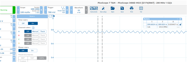

  •  and , at long last I can confirm that I am seeing the reference clock being generated on my SK-AM69 board! And yes, the driver was handling the configuration through dts; with the dts changes, I did not need to do manual register accesses.
    And what was the problem, you might ask? When we went to add the 50 Ω termination resistors to our board a few months back, the resistors that we used were accidentally 50 kΩ. man facepalming
    When we changed them to 50 Ω today, the reference clocks appear on the oscilloscope as expected.
    Thanks very much for your help throughout this case and for confirming the correct behavior on your end, because that's what spurred me on to find the problem with my board. Again, it's very appreciated.
