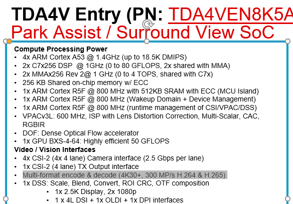

TDA4AEN-Q1: Can video Encoder and decoder works simultaneously?
Part Number: TDA4AEN-Q1
Dear Expert
This is spec. clarification.
As far as I know, H264 Encoder and decoder "can not" works at the same time? isn't?
If the answer is "yes", it can work at the same time. Does the processing capability (bandwidth) share w/  Encoder and decoder?
Thank You.
Gibbs
