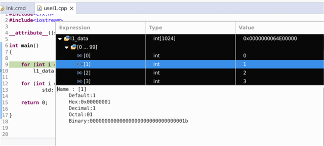

    I was able to read and write data from the same using the code snippet below :
    #include<iostream>
    __attribute__((section(".l1dmemory"), aligned(64))) int32_t l1_data[1024];
    int main()
         for (int i = 0; i < 1024; ++i)
            l1_data[i] = i;
            std::cout<< l1_data[i]<<",";
        return 0;
    Sivadeep
  • Sivadeep thank you for this helpful reply. First, the L1D address I shared earlier was a typo and we are actually using 0x64E00000 as you stated.
    The example you provided works correctly as you stated. Thank you.

    I hope this resolves your query.
    Sivadeep
