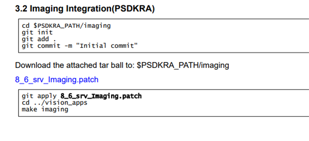

  • Hi Daigo,
    Can you refer to this appnote https://www.ti.com/lit/an/sprade5/sprade5.pdf?ts=1750407608218&ref_url=https%253A%252F%252Fwww.google.com%252F
    which has quick bring up of surround view demo. Refer to it and modify for your application as well.
    Gokul

  • Hi Gokul
    My customer understood how to change the boot mode(UBOOT->SBL) and load device from SD to eMMC. And they understand that linux dts optimise but there is difference H/W between SRV demo and customer's application. We will try to boot optimise.
    But there is big issue regarding Imaging Framework.
    So customer can't move next and solve about Camere driver because the driver is different between UB960/UB953 and D3 camera on customer's application. Could you help them how to consider the different driver .
    Ito
