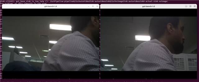

  • Hi Yi YeonCheon,
    I ran the command on my host PC:
    gst-launch-1.0 -v videotestsrc ! video/x-raw, format=NV12, width=1920, height=1080, framerate=30/1 ! x264enc ! queue ! rtph264pay ! tee name=t t. ! queue ! udpsink host=128.247.75.79 port=5000 t. ! queue ! udpsink host=128.247.75.79 port=6000
    Target EVM :
    gst-launch-1.0 -v udpsrc port=5000 caps = "application/x-rtp, media=(string)video, clock-rate=(int)90000, encoding-name=(string)H264, payload=(int)96" ! rtpjitterbuffer latency=50 ! rtph264depay ! h264parse ! v4l2h264dec ! kmssink driver-name=tidss sync=false
    gst-launch-1.0 -v udpsrc port=6000 caps = "application/x-rtp, media=(string)video, clock-rate=(int)90000, encoding-name=(string)H264, payload=(int)96" ! rtpjitterbuffer latency=50 ! rtph264depay ! h264parse ! v4l2h264dec ! kmssink driver-name=tidss sync=false
    For more than an hour or so,  I haven't observed the hang or stuck issue. Although sometimes the second stream appears on my display with some latency.
    I will try and run on 11.1 SDK that has already been released. You should not see those warnings any more as the commit is already part of 11.1 SDK
    https://git.ti.com/cgit/ti-linux-kernel/ti-linux-kernel/commit/drivers/media/platform/chips-media/wave5?h=ti-linux-6.12.y&id=eb39ef7d05eb995c941a74cb627f3a72b7458f61
    Suren

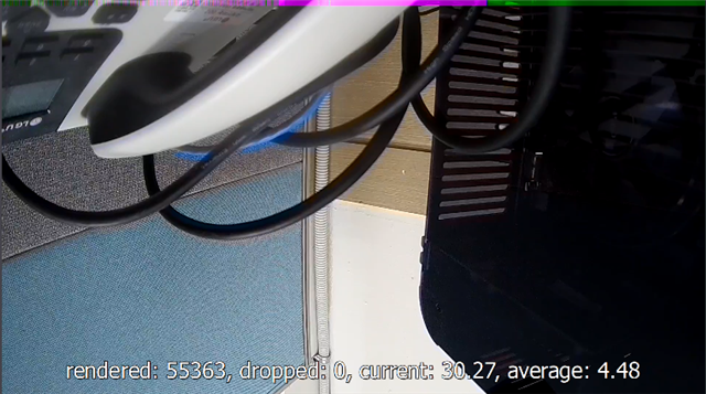

  • Hi Yeoncheon,
    I have tried with 2 camera inputs as well and didn't see any issue.
    Here is my setup.
    One AM62A board (Board A) (which has 4 cameras connected via FPD Link  all 1080p @30ps), I capture the camera input and encode using H.264 encoder and stream it via UDP to another AM62A board (Board B).
    On Board B (AM62A), I run the multistream.sh script (Which is decoding the incoming UDP streams from Board A) and encode using H.264 encoder and stream it my host PC via UDP.
    On my Host PC. I run the receive.sh script that I attached yesterday and I don't see any crashes after running it for more than 3 hours.
    I assume something is wrong with your setup or network which might be causing the issues.
    Also, if there is a decoder crash/ decoder stopped working, Gstreamer log would have captured it.
    Suren

  • Hi Jack,
    In my previous run, I am using camera inputs and it ran without any issues in an overnight run.

  • Hi YeonCheon,
    I ran both the streams on my setup with 11.1 SDK and didn't see any issues.

  • Hi YeonCheon,
    Its still running fine after more than 18+ hours of run. There are no artifacts observed.
    Suren

  • Dear Suren
    I tested it under the same conditions.
    However, when looking at the video, the timer at the top should keep increasing, but a few minutes after running the send pipeline, none of the timers continue to increase.
    I tested this with SDK version 11.01.07.05 downloaded from the TI site.
    In both videos, the timers stopped.
    By any chance, was the timer still continuously increasing even after 18 hours?

  • Dear Suren
    Yes. The timer in the upper-left corner of the video is supposed to keep counting up continuously.
    If it is not visible or remains stuck, it means the video is not being transmitted.
    Under the same setup, we consistently observe that the video keeps freezing.

  • Hi YeonCheon,
    Can you place the camera to point to something that has motion and not static image, so you would understand if its frozen or not.
    As I said I have tried decoding and encoding using 2 AM62A boards and streamed to my pc without any issues as previously shared.
    Suren

  • Hi YeonCheon,
    I tried playing with the setup today, but I was able to see only one camera feed. Don't see both.

  • Yes YeonCheon,
    I am able to see both the streams. Its been running fine for sometime.
    Did you find any issues that you were reporting on your end with 11.1 SDK?

    Even with the pipeline you provided, one stream works normally, but the lower-resolution video consistently stops decoding and freezes after a certain period of time (usually within an hour). Also, the version is not 11.1, but 11.01.07.05.
    As I have already mentioned several times, the smaller video completely freezes without any movement, and no information is printed in the logs. The timestamp from the sending GStreamer also stops, and no further progress is made.
    Best Regrads
