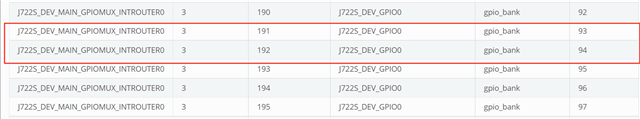

mcu20 requires the use of 191 and 192 banks Interrupt
However, due to the occupation of linux, after attempting to modify it now,
the linux gpio cannot be used, please fix my modification.

  • Hi Semon,
    These materials cannot solve the current problem. Please confront the current issue directly.
    Cesar
  • hese materials cannot solve the current problem. Please confront the current issue directly.
    Hi Cesar
        please refer to this change, I test it on EVM, Linux can bring up,
        then the left GPIO interrupt can be used for RTOS, for GPIO0: 193-195, GPIO1: 183-185

    Hello Cesar
        please try this patch, it use "gpio-reserved-ranges" to reserve GPIOS from used by Linux
        these reserved GPIOs should be used by R5F

    +++ b/arch/arm64/boot/dts/ti/k3-j722s-main.dtsi
    @@ -474,6 +474,7 @@ main_pmx0_range: gpio-range {
     &main_gpio0 {
     	gpio-ranges = <&main_pmx0 0 0 32>, <&main_pmx0 32 33 38>,
     			<&main_pmx0 70 72 17>;
    +	gpio-reserved-ranges = <16 32>;
     	ti,ngpio = <87>;
    diff --git a/drivers/gpio/Makefile b/drivers/gpio/Makefile
    index 1429e8c02..dbd110260 100644
    --- a/drivers/gpio/Makefile
    +++ b/drivers/gpio/Makefile
    @@ -1,6 +1,6 @@
     # SPDX-License-Identifier: GPL-2.0
     # generic gpio support: platform drivers, dedicated expander chips, etc
    +EXTRA_CFLAGS += -DDEBUG
     ccflags-$(CONFIG_DEBUG_GPIO)	+= -DDEBUG
     obj-$(CONFIG_GPIOLIB)		+= gpiolib.o
    diff --git a/drivers/gpio/gpio-davinci.c b/drivers/gpio/gpio-davinci.c
    index f2cc94c26..00dec7e4e 100644
    --- a/drivers/gpio/gpio-davinci.c
    +++ b/drivers/gpio/gpio-davinci.c
    @@ -26,6 +26,8 @@
     #define MAX_REGS_BANKS 5
     #define MAX_INT_PER_BANK 32
    +#define MAX_RSVRD_GPIO 16
     struct davinci_gpio_regs {
     	u32	dir;
     	u32	out_data;
    @@ -63,6 +65,8 @@ struct davinci_gpio_controller {
     	struct davinci_gpio_regs context[MAX_REGS_BANKS];
     	u32			binten_context;
     	bool		needs_context_restore;
    +	u32                     rsvrd_range[MAX_RSVRD_GPIO];
    +	int                     rsvrd_size;
     static inline u32 __gpio_mask(unsigned gpio)
    @@ -162,7 +166,7 @@ static int davinci_gpio_probe(struct platform_device *pdev)
     	struct davinci_gpio_controller *chips;
     	struct device *dev = &pdev->dev;
     	struct device_node *dn = dev_of_node(dev);
    +printk("%s %d, nirq %d\n", __FUNCTION__,__LINE__, nirq);
     	 * The gpio banks conceptually expose a segmented bitmap,
     	 * and "ngpio" is one more than the largest zero-based
    @@ -188,11 +192,7 @@ static int davinci_gpio_probe(struct platform_device *pdev)
     		nirq = gpio_unbanked;
     	else
     		nirq = DIV_ROUND_UP(ngpio, 16);
    -	if (nirq > MAX_INT_PER_BANK) {
    -		dev_err(dev, "Too many IRQs!\n");
    -		return -EINVAL;
    +printk("%s %d, ngpio %d, nirq %d\n", __FUNCTION__,__LINE__, ngpio, nirq);
     	chips = devm_kzalloc(dev, sizeof(*chips), GFP_KERNEL);
     	if (!chips)
    @@ -204,6 +204,7 @@ static int davinci_gpio_probe(struct platform_device *pdev)
     	for (i = 0; i < nirq; i++) {
     		chips->irqs[i] = platform_get_irq(pdev, i);
    +		printk("%s %d, irqs %d\n", __FUNCTION__,__LINE__, chips->irqs[i]);
     		if (chips->irqs[i] < 0)
     			return chips->irqs[i];
    @@ -229,8 +230,10 @@ static int davinci_gpio_probe(struct platform_device *pdev)
     	chips->gpio_unbanked = gpio_unbanked;
     	nbank = DIV_ROUND_UP(ngpio, 32);
    -	for (bank = 0; bank < nbank; bank++)
    +	for (bank = 0; bank < nbank; bank++) {
     		chips->regs[bank] = gpio_base + offset_array[bank];
    +printk("%s %d, nbank %d, bank 0x%x\n", __FUNCTION__,__LINE__, nbank, chips->regs[bank]);
     	ret = devm_gpiochip_add_data(dev, &chips->chip, chips);
     	if (ret)
    @@ -437,6 +440,42 @@ static struct irq_chip *keystone_gpio_get_irq_chip(unsigned int irq)
     static const struct of_device_id davinci_gpio_ids[];
    +static int davinci_gpio_reserved_ranges(struct platform_device *pdev)
    +	struct device *dev = &pdev->dev;
    +	struct davinci_gpio_controller *chips = platform_get_drvdata(pdev);
    +	u32 ngpio = chips->chip.ngpio;
    +	int size;
    +	int ret;
    +	u32 ranges[16];
    +	/* Format is "start, count, ..." */
    +	size = chips->rsvrd_size = device_property_count_u32(dev, "gpio-reserved-ranges");
    +	if ((chips->rsvrd_size > 0 && chips->rsvrd_size % 2 != 0) || (chips->rsvrd_size < 0)) {
    +printk("%s, %d, size %d\n",__FUNCTION__,__LINE__, chips->rsvrd_size);
    +		chips->rsvrd_size = 0;
    +		return chips->rsvrd_size;
    +	ret = device_property_read_u32_array(dev, "gpio-reserved-ranges",
    +					     chips->rsvrd_range, chips->rsvrd_size);
    +	if (ret) {
    +		return ret;
    +	while (size) {
    +		u32 count = chips->rsvrd_range[--size];
    +		u32 start = chips->rsvrd_range[--size];
    +printk("%s, %d, count %d, start %d\n",__FUNCTION__,__LINE__, count, start);
    +		if (start >= ngpio || start + count > ngpio)
    +			continue;
    +	return 0;
      * NOTE:  for suspend/resume, probably best to make a platform_device with
      * suspend_late/resume_resume calls hooking into results of the set_wake()
    @@ -532,6 +571,8 @@ static int davinci_gpio_irq_setup(struct platform_device *pdev)
     		goto done;
    +	davinci_gpio_reserved_ranges(pdev);
     	 * Or, AINTC can handle IRQs for banks of 16 GPIO IRQs, which we
    @@ -542,10 +583,26 @@ static int davinci_gpio_irq_setup(struct platform_device *pdev)
     		 * There are register sets for 32 GPIOs. 2 banks of 16
     		 * GPIOs are covered by each set of registers hence divide by 2
    +		if (chips->rsvrd_size) {
    +			int idx = 0;
    +			int start;
    +			int skip = 0;
    +			for (idx = 0; idx < chips->rsvrd_size; idx += 2) {
    +				printk("%s, %d, gpio %d, range %d, up %d\n",__FUNCTION__,__LINE__, gpio, chips->rsvrd_range[idx], (chips->rsvrd_range[idx] + 16));
    +				if (gpio >= chips->rsvrd_range[idx] && gpio < (chips->rsvrd_range[idx] + chips->rsvrd_range[idx+1])) {
    +					skip = 1;
    +printk("%s, %d, skip %d\n",__FUNCTION__,__LINE__, skip);
    +			if (skip) {
    +				continue;
     		g = chips->regs[bank / 2];
     		writel_relaxed(~0, &g->clr_falling);
     		writel_relaxed(~0, &g->clr_rising);
    +printk("%s, %d, gpio %d, bank %d\n",__FUNCTION__,__LINE__, gpio, bank);
     		 * Each chip handles 32 gpios, and each irq bank consists of 16
     		 * gpio irqs. Pass the irq bank's corresponding controller to
       semon
