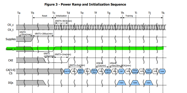

    Now customer meet one urgent issue on a mass production project, and want to check what is the logic behind the reset signal RESETN output from the AM3352 to the DDR? What are the preconditions after power-on?
    Note: The DDR section uses a 1.35V power supply. Two prototypes currently have this signal stuck low and not pulled high. Replacing the CPU and DDR with new ones hasn't resolved the issue. I've also confirmed that the connection between the two pads for this signal is working properly. What is the possible reason?

  • Zekun, the RESET_n signal will go high during DDR initialization procedure, which is executed in the bootloader.  Is the abnormal scope shot taken when the device is going through the normal boot procedure?  It looks like there may be a boot issue with the abnormal scope shot before the DDR initialization code is ever executed.  I would check the boot media and ensure the ROM is retrieving the bootloader correctly.  Is this only happening on some boards?

    Hi Zekun
          DDR reset signal is high and will be pull down for a short time then be pull up again, thus reset the DDR
          if the DDR_RSTn is always pulled down, maybe this is caused by some components failure in the HW board, such as capacitor in the circuit.
          if only one or two HW boards has problem, please let customer check the components in the board
       Semon
