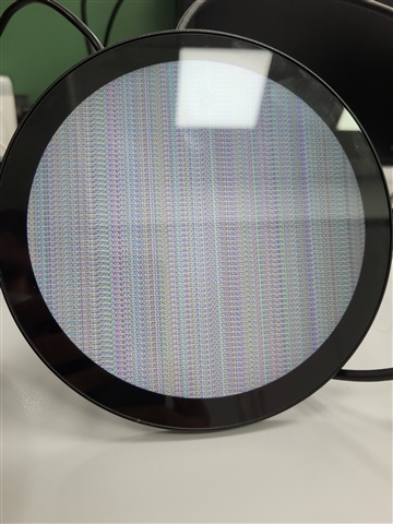

I am facing an issue with the Waveshare 5-inch 1080x1080 LCD https://www.waveshare.com/wiki/5inch_1080x1080_LCD
not displaying on the AM62L EVM board.
Below are the details of my setup and the steps I’ve taken to troubleshoot the issue.
Board: AM62Lx EVM
Display: Waveshare 5-inch 1080x1080 LCD
SDK: Flashed tisdk-default-image-am62lxx-evm-11.00.15.05.rootfs.wic.xz
Issue: The display does not work by default with the AM62L EVM. I suspect an HDMI timing issue, as the same display works out-of-the-box with the AM62P-LP board without any device tree modifications. Additionally, I connected the display to an Ubuntu machine and confirmed it works with the following timing parameters obtained via kms_print:
1080x1080@60.07 85.500 1080/68/32/100/+ 1080/16/4/12/+ 60 (60.07) P|D
DTD 1: 1080x1080 60.069 Hz 1:1 66.797 kHz 85.500 MHz (203 mm x 270 mm)
Hfront 68 Hsync 32 Hback 100 Hpol P
Vfront 16 Vsync 4 Vback 12 Vpol P
These parameters match the EDID settings provided in the Waveshare wiki:

Observations:
  • The display shows output but appears distorted or misaligned, suggesting incorrect HDMI timing settings.
  • The same display works perfectly on the AM62P-LP board and an Ubuntu PC without modifications.
Any assistance in resolving this HDMI timing issue or suggestions for further debugging would be greatly appreciated. Thank you!
  •   Could you please support .
  • Since it works with AM62P, lets try to figure where the delta is with AM62L.

    kmstest- same image i have shared in this ticket

    Same image i have shared in the ticket.

  • Cross-checking 2 things:
    1. You had removed your dts changes for above experiments?
    2. AM62L evm is working fine with any other hdmi display/monitor?
  • 1. You had removed your dts changes for above experiments? yes
    2. AM62L evm is working fine with any other hdmi display/monitor? yes.working fine in https://www.waveshare.com/10.1inch-hdmi-lcd-g-with-case.htm
  • Your issue seems related to  SK-AM62A-LP: 10.1 inch HDMI LCD display is not working well though you do not see any errors. Please stay tuned with that thread. Will share further info when we have it.

  •   The issue is not resolved with this patch. There are no i2c errors shown in the logs, and the display is working. I have already tried adding the display timing, but the issue still persists.
  • In your current debugs, has there been any difference in between working AM62P and non-working AM62L case? is there a difference in clocks?
