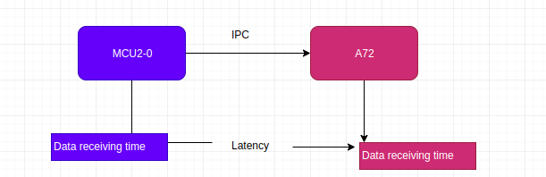

How do I measure the latency between MCU2_0 capturing camera data and A72 receiving it? What factors influence this latency? What are the factors that affect this delay? Is there any relevant documentation or thread?

    We'd like to know:
    #1
    How is the camera capture data from MCU2_0 transmitted to the A72? How is the data transmitted to the A72? Could you provide more details?
    #2
    How do I get the timestamp when the MCU2_0 receives the camera data?
    #3
    How do I get the timestamp when the A72 receives the camera data?

  • Hi Barry,
    mcu2_0 running capture_node will update the frame to the ddr_shared_memory which is shared across all the cores and triggers the next node connected to it. In case of multi_cam example you can get the captured frame's to A72 by using the vxGraphParameterDequeueDoneRef() api where it will return a openvx reference from which you can able to get image data. There is no transfer of data happens, everything is in shared memory, only ipc messages (around 512 bytes) are transferred from remote cores.

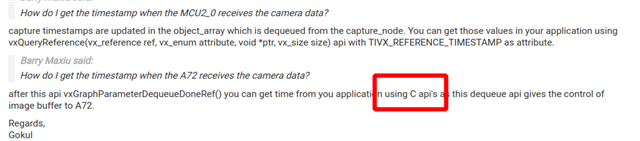

    capture timestamps are updated in the object_array which is dequeued from the capture_node. You can get those values in your application using
    vxQueryReference(vx_reference ref, vx_enum attribute, void *ptr, vx_size size) api with TIVX_REFERENCE_TIMESTAMP as attribute.
    after this api vxGraphParameterDequeueDoneRef() you can get time from you application using C api's as this dequeue api gives the control of image buffer to A72.

    #1
    What does the full C API designation refer to?
    #2
    How does TIVX_REFERENCE_TIMESTAMP on the A72 obtain a TIMESTAMP value? How is the TIMESTAMP passed to the A72? How is it implemented?
    Looking forward to your reply.thanks
  • Hi Barry,
    1. You can use appLogGetTimeInUsec(); api to get current time in your a72 application.
    2. vxQueryReference() api get the timestamp data from the obj_desc which is stored in shared memory, this time will be updated by the capture node running in mcu2_0 when it receives frame from csirx. Timestamp data is present in shared memory and a72 reads from it.
