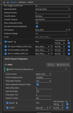

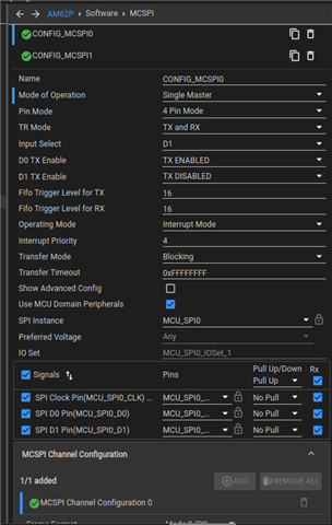

I am using the MCSPI to control the gyroscope. Based on the datasheet of gyroscope, when the SOC send a single frame ‘0xF5’ the gyro will respond with a single frame '0xFA'. The above process is feasible based on our test. However, when we try to send multi-frame via SPI, the gyro cannot respond normally and it only respond with '0x00'. I try to change the 'MCSPI_ChConfig.csIdleTime' to expand the interval for CS signal but it did not work.
I used logic analyzer to catch the wave and attached it below. The red line refers to single frame part and the green line refers to mutli-frame part.
I also attach the sysconfig configuration for spi channel.
The spi transfer code is shown below.

    Thank you for attaching the supporting configurations and the code snippet, this helps a lot.
    I see there is nothing wrong with the SysConfig configuration and the code snippet which you attached.
