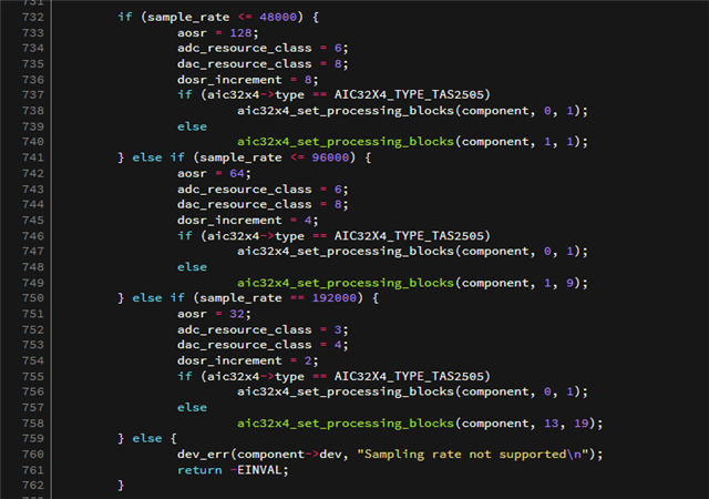

I'm working with the TLV320AIC3204 audio codec, which is interfaced with the AM6252 via McASP. In my setup, the codec operates as the master, with MCLK supplied through an external oscillator at 12.288 MHz. The BCLK and WCLK are also generated by the codec.
My requirement is to play audio using the codec at 8 kHz, 16 kHz, 32 kHz, and 48 kHz sample rates in different applications. One observation is that when I run a GStreamer pipeline with 48 kHz first, then stop and try running it with another sample rate, it throws an error: "unable to set hw_params."
With other NXP processors, I have not encountered such an issue.

    Yeah sure , i will provide the recorded file . One thing i observed when try to loopback from mic to speaker using  8khz sample rate
    gst-launch-1.0 alsasrc device="hw:0,0" ! audioconvert ! audioresample ! audio/x-raw, rate=8000 ! alsasink device="hw:0,0"
    im getting clock as
    MCLK : 12.288Mhz from OSC to Codec
    BCLK : 242 khz ( expected 256khz)
    WCLK : 8KHz
    There is mismatch in Bclk value which is  expected to get 256khz ( (sample rate * format *channels)=(8000*16*2)) .
    I assume noise might be due mismatch is BCLK .
    Where as im getting expected clocks for other sample rates of 16khz , 32 khz and 48khz . Please check from your side as well .

  • Hi Shekar,
    I went through the register dump and found that the clock dividers are very strange - and yes, what you measured of ~242kHz as the BCLK is the expected output with these registers. If you are not providing the clock dividers, it looks like the driver does its own calculations (that are very off). I would recommend you manually set the clock divider registers after the driver runs, or in the driver itself.
    I would recommend instead of the current dividers for 8k, using these:
    # J.D = 8.0000
    # DOSR = 256
    # NDAC = 6
    # MDAC = 4
    # BCLK NDIV = 16
    I will attach my annotated notes on the reg dump so you can see what all the dividers are doing. The 16k case also has weird PLL/divider values, but the rounding error is a bit smaller so it is less noticeable. Still, the BCLK does not work out to be exactly what it should, so I would recommend again:
    # J.D = 8.0000
    # DOSR = 256 (already is)
    # NDAC = 6
    # MDAC = 8
    # BCLK NDIV = 8
    Let me know what you think here.
    Mir
