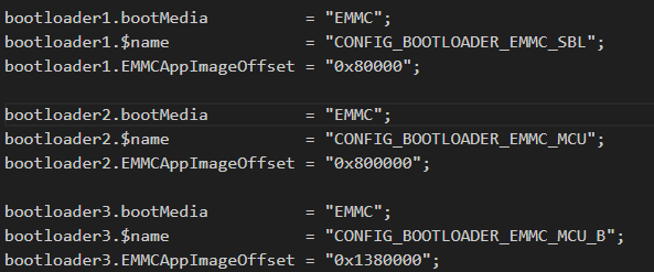

Q2. The firmware of MCU R5F defaults to flashing at location 0x800000 and is written by examples/drivers/boot/sbl_emmc_linux_multistage/sbl_emmc_linux_stage1/am62ax-sk/r5fss0-0_nortos/example.syscfg . It was configured before compilation. Can sbl_emmc_linux_stage1 dynamically select the address to load MCU R5F firmware? For example, partition A chooses to load location 0x800000, while partition B chooses to load another location such as x1800000.

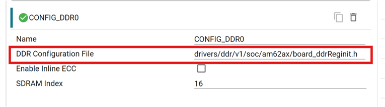

Q4. Is the initialization of DDR carried out in sbl_emmc_linux_stage1? How to configure DDR configuration generated by Sysconfig in code?

    For your first 3 question I assume by A/B booting you mean selecting which application to boot from 2 application flashed at different address in eMMC and not selecting from boot0 and boot1 partition of eMMC. If this is your use case, then yes, it is possible to achieve this, and you can add the selection logic in both Stage-1 and Stage-2 to boot different application, please refer to this thread: (+) TMDS64EVM: SBL to switch and launch user applications - Processors forum - Processors - TI E2E support forums
    This can give you an idea on how you can implement your usecase, here you would need to add additional bootloader instances for each core you are booting, so in stage-1 you can add an additional bootloader instance for MCU R5, and in stage-2 you can add additional instances for DM R5, A53 and HSM. You can then add your logic to select which image to boot in your SBL stage-1 and stage-2 code.
    Yes, the DDR initialization is done by SBL Stage-1, you can use the DDR Configurator tool for this: SysConfig After configuring this, you can add the generated board_ddrReginit.h file in syscfg file of sbl_emmc_linux_stage1 instead of the default one:

    Recently I have writed the stage1 code to verify it, the current progress is as follows.
    1. The A/B flag has been placed in the EMMC USER partition, and currently stage1 can recognize A/B flag and change it.
    2. stage1 can load the corresponding MCU A/B firmware now.

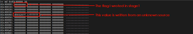

    3. Stage1 can pass the corresponding A/B flag through MSRAM at address 0x43C40000. For example, uboot or Linux can also recognize the current A/B flag through MSRAM at address 0x43C40000.
    But I have a few questions:
    1. The MSRAM area I am using has a starting address of 0x43C40000 and a length of 64KB. Is this specific usage plan defined by myself? Because I found that some of the content here is not set to 0 by default, I am worried that other cores may be using it.
    Yes you can use this address as long as any other application is not using this memory.
