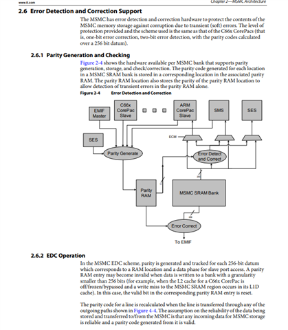

Symptom: A single-bit error occurred in the constant data of the 66AK2H06 processor's SL2 memory. The memory address was 0x0C3A4048, and the memory data changed from 0x0C38CB04 to 0x0C18CB04 (Bit 21 changed from 1 to 0). The device was powered on and running for nine months, and the log showed two single-bit error corrections in the SL2 memory.
Problem Analysis: The suspected cause of the problem is a write operation to other data in the same SL2 memory subbank. The small-scale write caused the ECC checksum to be temporarily invalid, which, combined with particle radiation, caused the single-bit error in the SL2 memory to persist.
Simulation test: Disable the SL2 memory background scanning function, compare large and small data writes to the same subbank, simulate a single-bit error in the same subbank, and observe whether accessing the erroneous data can trigger an ECC interrupt.
    Yes , Exactly. I think the partial memory write operation in SL2 memory causing the issue. We have to always use bit aligned and full-width writes to ECC-protected memory.

  • 1) To further supplement the previous simulation test case description: Disable L1D Cache and L2 Cache, turn off the SL2 memory background scan function, compare the write of large or small granules to the same SubBank, simulate a single-bit error in the same SubBank, and observe whether accessing the erroneous data can trigger an ECC interrupt.
    2) The on-site device actually uses L1D Cache and L2 Cache, with cache lines of 32 and 128 bytes respectively. Writing data to SL2 memory needs to go through the cache, meaning that theoretically, writing data to SL2 memory is a large granule write.
    3) May I ask if there is any small granule write or short-term invalidity of the SL2 memory ECC check code in the above actual working conditions? Please help analyze and provide feedback again. Thank you!

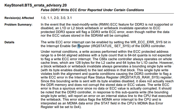

    The errata reports a false DDR3 (not MSMC) write ECC error under certain conditions and suggests possible workarounds.
    Could you please have a look at this https://www.ti.com/lit/er/sprz402f/sprz402f.pdf?. but we need to check whether it can be applicable for MSMC also.

    1)We have checked the DDR ECC configuration and enabled the RMW function. Does MSMC memory have a similar function?
    2)The on-site device actually uses L1D Cache and L2 Cache. If background scrubbing engine is not considered, is it possible for the MSMC memory ECC check code to fail in the short term?
    GQ Zhou
    The MSMC memory does not support Read-Modify-Write (RMW) ECC like DDR memory. Its ECC relies on aligned writes and standard error correction, with no special handling for partial or misaligned writes. RMW is exclusive to the DDR3 memory controller.

    1) We analyze one probable cause is single-bit error occurred in L1D Cache. Because L1D Cache does not have ECC/EDC function, When Cache data writeback to MSMC memory and single-bit error permanently occurs in the MSMC memory.
    2) The device actually uses L1D Cache and L2 Cache. when Cache data writeback to MSMC memory, Is ECC check code synchronously calculate and no need to wait scrubbing engine?
    3) Based on theoretical analysis, are there other probable causes?
    GQ Zhou
    The ECC is synchronously calculated by the MSMC memory hardware during the write operation.ECC check codes are generated and stored immediately as the data is written back, ensuring data integrity without delay. There is no need to wait for the scrubbing engine to calculate ECC during the normal cache writeback process.

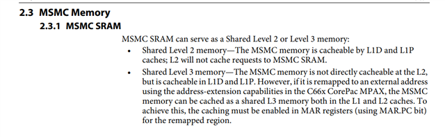

    2)When cache is used, is there any write to MSMC without going through cache?
    By default, if cache is enabled, MSMC/Level 2 memory is cacheable by both L1D and L1P caches, unless the memory regions are explicitly configured as non-cacheable.

    1) Our usage scenario is that MSMC memory only stores data, not code. Because cache data writeback to MSMC memory and ECC check codes are generated and stored immediately. Is it no need scrubbing engine when enabling L1D cache?
    2) Return to our original problem(single-bit error in the MSMC memory occured and persisted), are there other probable causes? Is L1D cache error the only cause?
    GQ Zhou
    Even with L1D cache and ECC on writeback, the scrubbing engine is needed to keep MSMC memory reliable by regularly finding and fixing errors over time.
