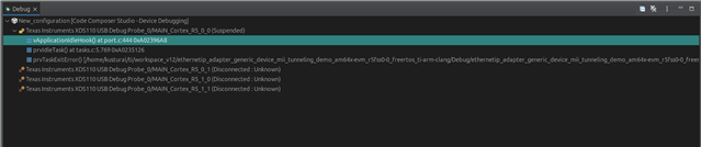

  • The logs of the FreeRTOS running on R5f_core0 is not showing up on UART1
  • The virtual ethernet interface is coming up, but is not pingable from Host PC.
  • The leds on the ICSSG port are off (maybe related to the upper point)
I have debugged FreeRTOS in CCS, but it only show an idleTaskError.
Here the complete dmesg log and the ethernet interfaces:

It would be nice, if you could help me out.
Luka
  • Hello Luka,
    Ok, so the good news is that we are not seeing some of the issues yall observed previously. Looks like the virtio channel is being created once during boot up, instead of multiple times 15-300 seconds after boot. That is already a good sign.
    I have not run this example on SDK 11 myself, and I will not have bandwidth to get the example running this week. I am in discussions with the developers to get some initial feedback for you. Please ping the thread if I have not responded with more within a couple of business days.
    Nick
