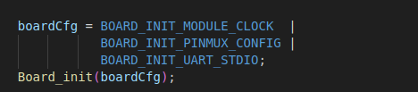

I need to do that because those steps are required inside the memcpy_main_baremetal.c TI file. Because there have always been an issue while trying to use directly the Board_init() function (code that runs in loop), I kinda bypassed this function, and implemented this code based of the Board_init() function in the board_init.c file

    It's normal, I'm not using the Board_init() function as I mentioned in my previous message. So I do not need to initialize the values of cfg. I already tried to use it, but since it didn't work, I bypassed it by only implementing the part of the code that performs the initialization of the three modules (BOARD_INIT_MODULE_CLOCK, BOARD_INIT_PINMUX_CONFIG, and BOARD_INIT_UART_STDIO).

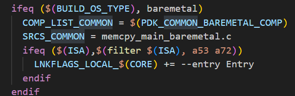

    • Are you building the code you mentioned above using the C7x core?
      From the screenshots you shared, it appears that you're using the C7x compiler. However, based on the makefiles for memcpy_main_baremetal.c, this file seems to be supported only for the A53 and A72 cores.

    • Indeed, I'm building and running the memcpy_main_baremetal.c file on the C7x. Okay, so you mean that's the code is not supported for the C7x core? Where have you found the makefiles related to this file ? What about the umda_memcpy_test.c ? Is it supported by the core C7x ?

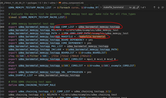

  • I don't have the same makefile as you... Could you give the path of yours. This what I found in the makefile_baremetal
    If you want to use "makefile_baremetal", you need to build the applicaiton udma_baremetal_memcpy_testapp.
    From the TI SDK, above application is not supported for the C7x core?
    Please refer to pdk/packages/ti/drv/udma/udma_component.mk file about the above application supported cores.
    Please check which application you are loading on C7x_1 core? Is it built for C7x_1 or not?
    Also, as requested above, please share the command used to build the application and the binary loading on the C71x core.

  • Hi Doredla,
    I checked the Makefile in the UDMA folder and noticed that the code I wanted to run on the C7x core is not supported for my use case (I'm working on baremetal).
