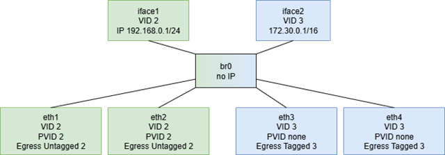

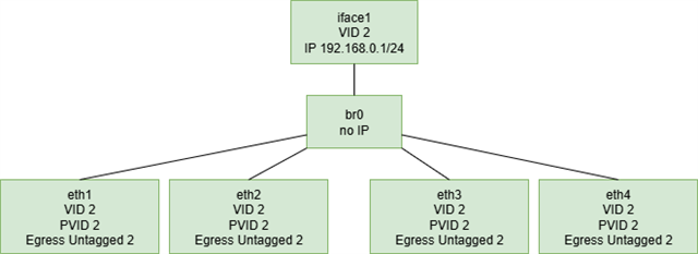

We run CPSW9G in native ethernet configuration with SDK 11.
Two (or more) external switch ports belong to the same VLAN. On A72 we also use this VLAN to receive/send packets.
When sending unicast packets from an external system to A72 via one switch port we see these packets duplicated on the other switch ports. Making the switch behave like a hub. The replies from A72 to the external system are not duplicated.
We see this behavior in switch mode and mac mode.

We already tested more or less every available setting. Do you have any idea what we are missing?

  • Hi Matthias,
    I am assuming here that you have created a bridge interface and added all the required interfaces as its daughter interfaces. That is an important step for enabling switch mode in TDA4VH.
    Please see here for more details on switch mode : https://software-dl.ti.com/jacinto7/esd/processor-sdk-linux-j784s4/11_00_00_08/exports/docs/linux/Foundational_Components/Kernel/Kernel_Drivers/Network/CPSWng-Native-Ethernet.html#cpswng-native-ethernet
    If this is done, can you share the output of "ip -a" on linux.
    I am suspecting that bridge is registered with its own separate MAC address and its not using the constituent MAC address of its daughter interfaces.
    If eth1 is part of br0, can you try running the following command and see if it resolves the issue:
    ip link set dev br0 address `ip link show dev eth2 | tail -1 | awk '{print $2}'`

  • Hi Tanmay,
    Your assumption is correct. We joined the switch ports to a bridge interface and configured everything accordingly (VLANs etc.). The bridge also had it's own MAC address.
    Using a MAC address of one of the switch ports did not resolve our issue. However, using the MAC of one of the VLAN interfaces seems to fix it (i.e. the MAC of an interface added with "ip link add link br0 name if2 type vlan id 2").
    Thanks for pointing us in the right direction.

    The duplication is still happening and I analyzed it a bit further.
    - Without any changes to the MAC address of the bridge interface the duplication is happening for 240s and then stops for 60s and the cycle repeats.
    - After changing the MAC address of our bridge interface the duplication stops for about 1min. This has no effect on the overall cycle of 240s duplication and 60s no duplication
    - "bridge fdb show" shows no difference between the duplication and no duplication.
    - xf2 is the port on which the duplicated packets leave our board. "ethtool -d xf2" shows no entry for any of the affected MAC addresses.
    I reduced our network configuration to better analyze the issue.
    - xf4 is the port on which the packets, addressed to kli, arrive
    - The packets are duplicated onto xf2
    - kli is a VLAN interface with VID 2
    - koni is a VLAN interface with VID 3
    - I check the duplication on another device connected to xf2

    $ bridge vlan show
    port              vlan-id
    xf2               2 Egress Untagged
                      3 PVID Egress Untagged
    xf4               2 PVID Egress Untagged
    switch            2
                      3

    Matthias
  • Hi Matthias,
    This is weird. I couldn't see anything which can also explain this in The ALE entries. Can we have a call to debug this issue further.
    Tanmay
  • Hi Tanmay,
    Sure. I have time for a call tomorrow. I guess you can see my e-mail address and send me an invitation?
    Matthias
  • Hi Tanmay,
    I found the source of the pauses in duplication.
    To check the duplications I used another Jacinto board with CPSW9G. After changing the MAC address the rx_port_mask_drop counter of the receiving board increases. So the duplication is still happening, I just can't see it with tcpdump.
    I now use another machine and the duplication persists.
    Matthias
  • Hi Matthias,
    But why would there be pauses for this. Are they coming when you change the MAC address?
    About the call, I think we will be able to tomorrow 3pm IST. I think you are in europe time-zone. So should also be feasible  for you. Let me send you an invite over email.
    Tanmay
  • Hi Tanmay,
    Yes, I have pauses when I change the MAC address. But I also have the pauses every 4 minutes. I don't really understand what's causing this. Since this is the receiving part for network packets, which are not addressed to this board, I'm not to concerned about it at the moment.
    I was able to debug the our problem a bit further.
    In MAC mode:
    - When I change the MAC address of the bridge interface to the MAC address used by our VLAN interface (kli), the duplications stop.
    In switch mode:
    - Changing the MAC address of the bridge interface doesn't stop the duplications.
    - However, if the MAC address of the bridge interface is different than that of the VLAN interface, I see every duplicated packet twice. Probably from the switch HW and linux settings. Changing the bridge MAC back to the same MAC as the VLAN interface, makes the second duplications disapear.
    My conclusion so far is, that your first suspicion was correct. The different MAC addresses cause the duplication. In software, I can disable this by setting the same MAC addresses. But somehow this doesn't apply to the HW in switch mode. There the duplications persist.
    Matthias
  • Hi Tanmay,
    I think the error is more or less clear to me now.
    In switch mode the ALE table of the switch doesn't contain any entry for the MAC addresses of the host system. This leads to the packets, addressed to the host, being send out on every port with the same VLAN ID. Which includes the host port and the port connected to the other system.
    Host system network interfaces:
     $ ip a

           valid_lft forever preferred_lft forever
    Host system ALE table:
     $ sudo ethtool -d xf2
    K3 CPSW dump version: 1, len: 11704
    (Missing registers in memory space can be considered as zero valued)
    cpsw-nuss regdump: number of Registers:(16)
    00000000:reg(6BA03102)
    00000010:reg(000000FF)
    cpsw-nuss-rgmii-status regdump: number of Registers:(16)
    cpsw-nuss-mdio regdump: number of Registers:(128)
    00000f00:reg(00070907)
    00000f04:reg(8100013F)
    00000f08:reg(00000F07)
    00000f0c:reg(00000007)
    00000f10:reg(00000003)
    00000f20:reg(00000001)
    00000f30:reg(00000001)
    00000f38:reg(FFFFFFFF)
    00000f80:reg(63E20A42)
    cpsw-nu regdump: number of Registers:(144)
    00020000:reg(6BA82902)
    00020004:reg(00006004)
    00020014:reg(0000007F)
    00020020:reg(00003001)
    00020024:reg(0000000B)
    00020028:reg(00000008)
    00020030:reg(FFFFFFFF)
    00020038:reg(FFFFFFFF)
    0002003c:reg(FFFFFFFF)
    00020050:reg(88A88100)
    00020100:reg(000007E8)
    00020104:reg(000007E8)
    00020108:reg(000007E8)
    0002010c:reg(000007E8)
    00020110:reg(000007E8)
    00020114:reg(000007E8)
    00020118:reg(000007E8)
    0002011c:reg(000007E8)
    cpsw-nu-p0 regdump: number of Registers:(402)
    00021004:reg(00010001)
    00021008:reg(00000052)
    00021010:reg(00000002)
    00021014:reg(00000001)
    00021018:reg(76543210)
    00021020:reg(76543210)
    00021024:reg(000007E8)
    00021028:reg(01245678)
    00021038:reg(00000060)
    00021180:reg(1F1F1F1F)
    00021184:reg(1F1F1F1F)
    00021190:reg(1F1F1F1F)
    00021194:reg(1F1F1F1F)
    00021300:reg(04030201)
    00021304:reg(08070605)
    cpsw-nu-pn regdump: number of Registers:(468)
    00022008:reg(00001004)
    00022010:reg(00000001)
    0002201c:reg(00009000)
    00022020:reg(76543210)
    00022024:reg(000005EE)
    00022028:reg(01245678)
    00022038:reg(00000062)
    00022040:reg(00000008)
    00022048:reg(001312D0)
    00022050:reg(0000FF00)
    00022180:reg(1F1F1F1F)
    00022184:reg(1F1F1F1F)
    00022190:reg(1F1F1F1F)
    00022194:reg(1F1F1F1F)
    00022314:reg(001E0000)
    00022320:reg(00040000)
    00022334:reg(E0000000)
    0002233c:reg(003F0000)
    000223a4:reg(0000000C)
    cpsw-nu-cpts regdump: number of Registers:(38)
    0003d000:reg(4E8A010C)
    0003d004:reg(00020021)
    0003d010:reg(81F9A69B)
    0003d028:reg(00000001)
    0003d044:reg(185B398B)
    cpsw-nu-ale regdump: number of Registers:(160)
    0003e000:reg(00290105)
    0003e004:reg(80000C01)
    0003e008:reg(80000105)
    0003e010:reg(0004E200)
    0003e014:reg(00002580)
    0003e020:reg(00000010)
    0003e034:reg(00000080)
    0003e038:reg(00030100)
    0003e03c:reg(5E7FFF13)
    0003e040:reg(00000003)
    0003e054:reg(00000003)
    0003e058:reg(00000003)
    0003e100:reg(000F0000)
    0003e120:reg(00000007)
    0003e12c:reg(80000000)
    0003e134:reg(00008000)
    0003e138:reg(00000007)
    0003e13c:reg(00008000)
    Number of ALE entries: 512
    0: Type: Inner VLAN
            Nolearn Mask = 0x0, Ingress Check = 0
            VLAN ID = 0, Registered Mask = 0x7f, No Frag = 0
            Force Untagged Packet Egress = 0x7f, Limit Next Header Control = 0, Unregistered Mask = 0x7f, Members = 0x7f
    1: Type: Multicast
            Address = 01:80:c2:00:00:00, Multicast_State = Blocking/Forwarding/Learning, Super, port_mask = 0x1
    2: Type: Unicast
            VID = 1, Address = 00:60:c8:63:07:95, Unicast_type = Persistent, port_num = 0x0, Secure = 1, Blocked = 1, Touch = 0, Agable = 0

    Could you also provide a working configuration with two separate VLANs for eth1/eth2 and eth3/eth4. As this is closer to our use case and the part were we experience basically all of our problems. Unfortunately, to me the documentation is not clear enough on how to achive the correct switch configuration for this use case.
    I.e.:
    - eth1 and eth2 use VID 2 and connect to a virtual VLAN interface iface1 with VID 2. Egress on eth1/eth2 is untagged and PVID is 2.
    - eth3 and eth4 use VID 3 and connect to a virtual VLAN interface iface2 with VID 3. Egress on eth3/eth4 is tagged and there is no PVID.
    - br0 has no IP and iface1 and iface2 lie in two separate subnets
    Here a picture describing our scenario:
    Matthias

  • Hello Tanmay,
    I managed to debug our issue further.
    I extended on your setup and added a VLAN interface.
    We set the MAC addresses of the switch ports in the device tree. I don't specifically set the MAC address of br0 or iface1 so they automatically get the MAC address of one of the switch ports.
    In this setup we don't get any duplications on the other switch ports.
    Unfortunately, this doesn't satisfy our use case for Profinet. For Profinet we change the switch port MAC addresses from user space.
    This means, the switch ports have a new MAC which is then automatically assigned to br0 and iface1. (Technically, this doesn't satisfy our Profinet use case either. It just points out the error more clearly).
    In this case we only get no duplications when using VID 1. Any other VID creates duplications on the other switch ports.
    In this scenario, if we compare the FDB entries in the kernel with the ALE entries on the switch, we see that there is an entry with the new MAC address and new VID in the FDB but it is missing in the ALE.
    In case of VID 1 the FDB entries appear in ALE. But for any other VID they are missing.
    FDB entries with new MAC:
    00:60:c8:05:fd:04 dev eth1 vlan 2 master br0 permanent
    00:60:c8:05:fd:04 dev eth1 vlan 1 master br0 permanent
    00:60:c8:05:fd:04 dev eth1 master br0 permanent
    ALE entries with new MAC only for VID 1:
    6: Type: Unicast
            VID = 1, Address = 00:60:c8:05:fd:04, Unicast_type = Persistent, port_num = 0x0, Secure = 1, Blocked = 1, Touch = 0, Agable = 0
    So it seems as if the learning_sync between FDB and ALE is not working correctly. New FDB entries concerning br0 are not applied by TI's switch driver.
    Can you please confirm my observations on your setup?
    Matthias
