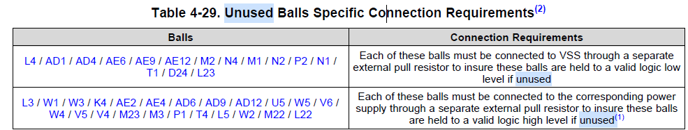

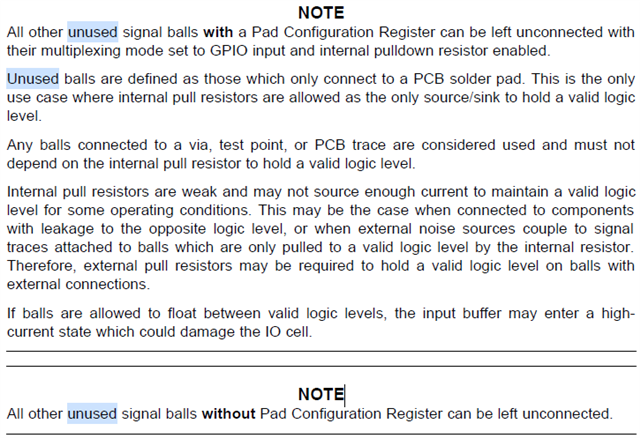

I have a question about 66AK2G12 unused pins mentioned in Table 4-29,I don't use these pins, so I want to left these pins float, if I left these pins unconnected, What will happen?

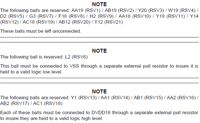

Not following the datasheet requirements for unused pins could result in increased power consumption, unexpected behavior, and reduced reliability.
