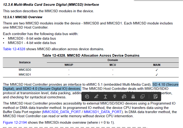

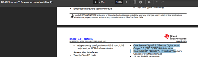

Hi, Dear Expert
As title description, What is SDIO Spec?
Does it SDIO 3.0 or SDIO 4.0?
Because I saw something different.
In datasheet,
In TRM,
Which spec is correct one?

Thanks for catching this. The correct specs for DRA821U is SD3.0/SDIO3.0. The datasheet has the correct information here.
The TRM is mistaken here, and we will plan to change this in the next revision of the TRM.
