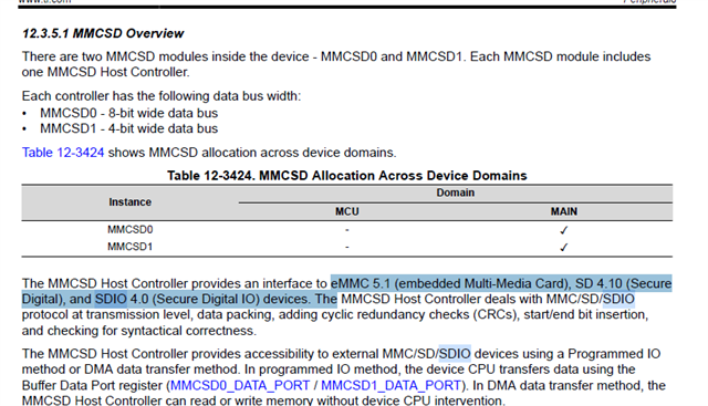

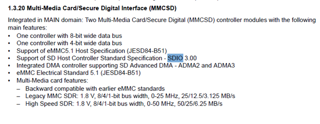

As title description, What is SDIO Spec?
Does it support SDIO 3.0 or SDIO 4.0?
Because I saw something different.
In TRM, p23, it says support SDIO 3.0
But in TRM p8719, it says support SDIO 4.0
Which is correct one?
Thank You.

Hello Gibbs,
Thank you for the query.
please refer the data sheet.
6.10.5.12.2 MMC1 - SD/SDIO Interface
6.10.5.12.2 MMC1 - SD/SDIO InterfaceMMC1 interface is compliant with the SD Host Controller Standard Specification 4.10 and SD Physical Layer Specification v3.01 as well as SDIO Specification v3.00 and it supports the following SD Card applications:
• Default speed
• High speed
• UHS–I SDR12
• UHS–I SDR25
• UHS–I SDR50
• UHS–I SDR104
• UHS–I DDR50

Hello Gibbs,
We verified the TRM content internally.
The datasheet is correct and references to 4.x in the TRM will be updated.
Sreenivasa
