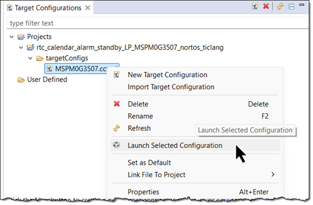

CCS Eclipse (v18) provided the ability to "Launch Selected Configuration" .ccxml file. This launched the debugger without connecting to the target or loading a program.
Does CCSv20 support this option? The closest I can find is either:
  • Right-click on .ccxml file and selecting "Start project-less debug".
  • View -> Connected Targets, then click "Debug" and click the Debug Icon in the Connected Targets toolbar
Both methods seem to start the debugger but I cannot tell if the target is connected. I am guessing that it is not connected because I get the following error when I try to Load a program:
GEL: Target must be connected before calling the function

  • Hi Scott,
    Yes, these would be the equivalent functionality.
    The target is not connected by default. This would mimic CCS Eclipse behavior.

  • If we do not modify the launch.json to auto-connect, is there a "Connect to Target" button like we had in Eclipse? Or to get this to work, do we need to invoke it through the json file?
    BTW, the page you referenced actually states that autoconnect is TRUE by default.
    • autoConnect: Boolean value that determines if the debugger should automatically connect to this core during debugger startup. Default value is true.
    In the end, I can see that this new methodology is probably much more flexible. (And the way it's done in Theia.) But since I don't really need this feature right now, I'll probably just remove it from the Appendix where we talk about this in the new course Eric and I are getting ready to release. Without a few more examples, it just seems like it will take a lot of trial and error to figure it out. That said, I appreciate your help in clarifying things a bit.
    It needs to be configured in the json file.
    The description is incomplete in the document. It is TRUE for a project debug. It is FALSE for a project-less debug. I'll have the document corrected. Thank you for pointing it out.
