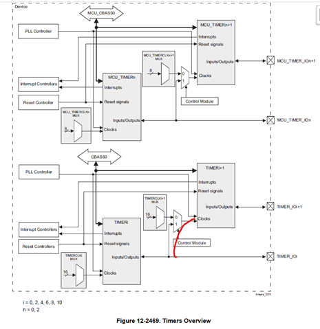

    Your understanding is slightly incorrect.  I do want the two timers tightly coupled, with the first timer clocked by 48MHz connected to EXT_REFCLK1 on our board, and overflowing at a 10uS rate. The cascaded timer will count 10uS overflows, and the firmware will read the second timer to get synchronized elapsed time measured in 10uS ticks.  I was not thinking of using any interrupts in this setup. I got this concept by reading the AM6421 TRM, Section 12.5.3.1
    "When cascaded, TIMERi acts as a 32-bit prescaler to TIMERi+1, as well as MCU_TIMERn acts as a 32-bit
    prescaler to MCU_TIMERn+1. TIMERi / MCU_TIMERn must be configured to generate a PWM output edge at
    the desired rate to increment the TIMERi+1/ MCU_TIMERn+1 counter."

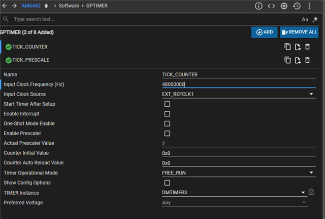

    2. If so, how do I write to the CASCADE_EN bit in CTRLMMR_TIMER3_CTRL?  I tried adding a direct instruction to my "C" code like this:
    #define CTRLMMR_TIMER3_CTRL (0x4300420CuL)
    #define CASCADE_EN (0x100uL)
    *(volatile uint32_t*)CTRLMMR_TIMER3_CTRL = CASCADE_EN;
    After running this during startup, I later stopped my debugger and checked the value of CASCADE_EN bit.  It was not set.  Is am now thinking that I need to use CTRLMMR_LOCK0_KICK0 to unlock access first, but an example from you would be helpful.

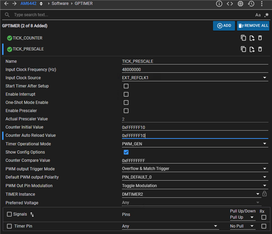

    Here is the cascaded timer setup I have so far from Sys?Cfg gernated setup of timers 2 and 3.  This code is from the autogenerated ti_drivers_config.c file. Please let me know if I'm on the right track.
    /* GPTIMER atrributes */
    static GPTIMER_HwAttrs gGpTimerHwAttrs[GPTIMER_NUM_INSTANCES] =
    .baseAddr = 37945344,
    .intNum = 155,
    .eventId = 0,
    .inputClk = 25000000,
    .enableIntr = false,
    .intrPriority = 4,
    .baseAddr = 37879808,
    .intNum = 154,
    .eventId = 0,
    .inputClk = 48000000,
    .intrPriority = 4,
    /* GPTIMER objects */
    static GPTIMER_Object gGpTimerObjects[GPTIMER_NUM_INSTANCES] =
    /* Timer Mode Configuration*/
    .timerConfigMode = GPTIMER_MODE_CONFIG_FREE_RUN,
    /* Callback Assignment */
    .overflowCallbackFunction = NULL,
    .compareMatchCallbackFunction = NULL,
    .captureCallbackFunction = NULL,
    .timerConfigMode = GPTIMER_MODE_CONFIG_PWM_GEN,
    .pwmConfig.trigOutputPWMMode = GPTIMER_PWM_OUT_OVERFLOW_TRIGGER,
    .pwmConfig.defaultPWMOutSetting = GPTIMER_PWM_OUT_PIN_DEFAULT_0,
    .pwmConfig.cntCompareValPWM = 0,
    .pwmConfig.outputModulationType = GPTIMER_PWM_OUT_PIN_MODULATION_TOGGLE,
    /* GPTIMER Config */
    GPTIMER_Config gGpTimerConfig[GPTIMER_NUM_INSTANCES] =
    .object = &gGpTimerObjects[TICK_COUNTER],
    .hwAttrs = &gGpTimerHwAttrs[TICK_COUNTER]
    .object = &gGpTimerObjects[TICK_PRESCALE],
    .hwAttrs = &gGpTimerHwAttrs[TICK_PRESCALE]
  • I've made some progress today.  I got TIMER2 configured as described in teh TRM fas a PWM to prescale TIMER3.  I was also able to turn on the CASCADE_EN bit for TIMER3 using this sequence:
    // Enable cascade of Timer2 to Timer3
    *(volatile uint32_t*)(CTRL_MMR0+CSL_MAIN_CTRL_MMR_CFG0_LOCK1_KICK0) = 0x68EF3490; //unlock step1
    *(volatile uint32_t*)(CTRL_MMR0+CSL_MAIN_CTRL_MMR_CFG0_LOCK1_KICK1) = 0xD172BC5A; //unlock step2
    *(volatile uint32_t*) (CTRL_MMR0+CSL_MAIN_CTRL_MMR_CFG0_TIMER3_CTRL) = CASCADE_EN;
    *(volatile uint32_t*)(CTRL_MMR0+CSL_MAIN_CTRL_MMR_CFG0_LOCK1_KICK0) = 0; // relock
    GPTIMER_init();
    ** Prescale timer2 cascaded to freerunning timer3
    ** Initial params set up with SysCfg tool
    // TickPrescaleHandle = GPTIMER_open(TICK_PRESCALE, NULL); // see params set up in SysCfg
    TickPrescaleHandle = gGpTimerHandle[TICK_PRESCALE];
    // Free running timer
    // TickCounterHandle = GPTIMER_open(TICK_COUNTER, NULL); // see params set up in SysCfg
    TickCounterHandle = gGpTimerHandle[TICK_COUNTER];
    /* Start the Timers */
    GPTIMER_start(TickPrescaleHandle);
    // GPTIMER_start(TickCounterHandle);
    Here are screenshots from SysCfg for my two timers
    Notice that I have commented out the second GPTIMER_start.  If this instructions is included, the program crashes during this call.
    I think I'm getting closer.  Can you confirm I'm on the right track and provide a bit of help?
  • I studied your original feedback a bit more and have a question about the description of cascade operation.  I want to be able to read out the count from the upper cascaded timer and just want it to provide the free running count.  In order to read it, I need a handle to use the GPTIMER interface.
    I'm still not sure if I am configuring the two timers correctly.  I'm moving along with other code in my application assuming I can use this method to get a synchronized 10uS tick between the CC1354 and AM6421 on my board.  If this method is not feasible, please suggest an alternative approach

    In cascade mode, the output signal of Timer i can be used as the input to Timer i+1.
    This allows the timers to operate together in PWM mode or timer mode under cascade operation.
